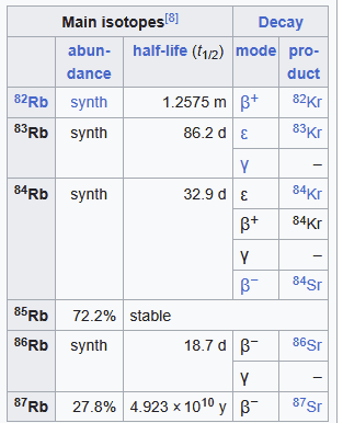

I tried to find the ratio of rb88/rb87 but can't find any. What are the ratio of rb88/rb87 in nature?
Rb88 has a half life of ~18 minutes, so effectively 0.

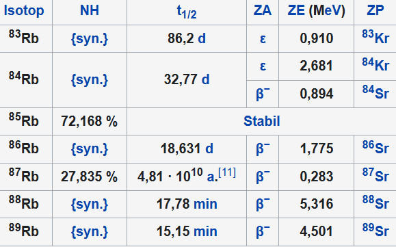

The natural abundance of Francium 223 and Oxygen 15 are trace. In comparison with Francium 223 or Oxygen 15, are both trace?
https://de.wikipedia.org/wiki/Rubidium

Rev. Cheeseman said:
In English wikipedia, it is just blank.
No it isn't
Baluncore said:
Oh I see. These tables only list the principal isotopes, a longer list can easily be found (e.g. by searching the interweb for "rubidium 88") at https://en.wikipedia.org/wiki/Isotopes_of_rubidium.
