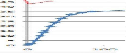

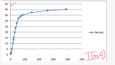

this is from post 192
I thought this may be of help, I took extracts from my large data set where I was exciting the two series 200 turn coils, for values where the DC was off, remember V3 is the voltage across the Amp:
is current really 0 to just 100 microamps ? I have to think you meant 100 milliamps...
and was this with a lamp load or just the coils across a supply ?
Lamp load will not allow big current peaks , the voltage will shift from coils to lamp during that part of wave, meaning we no longer have sinwave excitation voltage nor do we have cosine flux.
That's my best guess right now...

That's quite right, I think a few posts later I made a correction of that it was A not mA. Also you can see it's BH curve in post #214. That was for the lamp in series with the 400 turns, with the DC control OC, V3 was the voltage just on the 400 turns, but the current was ofcourse going through amp and lamp-load.jim hardy said:is current really 0 to just 100 microamps ? I have to think you meant 100 milliamps...and was this with a lamp load or just the coils across a supply ?

this curve ? Taken with lamp load?tim9000 said:This is probably my most important point of interest at the moment, because when I create an expectation of impedance for a 400 turn curve using the mu curve from the 840 turn BH curve, it is different to if I use a mu from this curve to generate an impedance curve for a 400 turn. (as in Z = wL as a function of B/H)
I find it crazy they're not the same shape BH curve, I can't explain it.
compared to this one, with no lamp load?
and stretch its horizontal axis to about same as upper one that goes only to 100 ma
that places 100 ma on both plots at at about four fingers out on horizontal axis, on my screen
and 35 volts per coil about two fingers high
still , in your upper curve out past the knee current rises more slowly with voltage, which i'd attribute to load resistance reducing peak currents.
can you rescale your plot and see what it looks like?
View attachment 87965Let me take that lower one which goes to 500 ma

tim9000 said:Which graphs are you talking about? The 200 turn and 400 turn? Is that just a coincidence? Well what I mean about the load affecting the curve shape slower rise before saturation too, is:
These two graphs
and
which i think are observed volts versus observed amps

But I've had a think and I may have made a bit of progress regarding the BH of the 400 turn, I think I was using a wrong magnetic path length, increasing it, it looks like this:
You can see it's closer to the 840 and 200 turn BH curves, HOWEVER I also had to change the 200 turn magnetic path length from 0.2274 to 0.28m, to get it to sit exactly over the 840 turn BH curve as you see above. BUT the 400 turn curve IS STILL FORWARD a bit and I'd like to know why! So it's permeability still isn't quite right, which is infuriating. You can read in the blurb in the picture, I think that as you said the non true RMS meter becomes dodgier and dodgier as the voltage gets higher and KVL is no longer represented truely. So I think that the current is probably pretty accurate and each voltage reading gives an 'ok' impedance when divided by the current, but still not great, and if you add the voltages up to get a resistance value than you're compounding the inaccuracy, as demonstraited if you used a calculated expectation of the bulbs:
Zload = 50.4 + 2008.8*current [Ohm]
That will give an even more dramatic divergence in the 'indirect curve' shape:
So I'm not sure what's reliable and what's not anymore, due to the non true rms. You're going to have to remind me, does a DMM measure the peak and calculate RMS or vice-versa? I take it, that it gets peak and estimates RMS? If so then that means V1 is reliable because it is a very sineusoidal supply, and that probably VL is reliable but that since V3 is going over the knee that the voltage on that gets less and less accurate and that's the source of inaccuracy. If so that means that it was actually my V3/I curve that was wrong and that the permeability was actually higher than I thought and the expected inductance was probably correct?
EDIT:
Using the notion that V3 was actually the unreliable weak link in KVL, for the aforementioned DMM reason, I calculated V3 = V1 - VL, and used that to calculate B, HOWEVER I REMEMBERED THERE WAS A SPLIT IN THE CENTRE LEG, I'd been modeling it as all a one piece core, BUT I suppose that's only true when there is a DC excitation. So by fitting the BH curves I can see that there is an effective magnetic path length of 0.6m, so using that to calculate H, then the curves fit and the permeability is almost the same, so the predicted impedance of the amp at that [A/m] is 1252 Ohms and the actual calculated impedance using (V1-VL)/I = 1260 Ohm, so they're really close now as you can see (400 turn indirect):
You can also see that the voltage on the amp starts to drop as the voltage on the bulb starts to rise at the knee point. As you predicted.
So was I right about the RMS of V3 being a red-herring?

So there really isn't a ΔV/ΔI, infact Z*N = V/I = dΦ/dI ?
That is to say, 'the tangent to the BH curve IS the direct V/I curve value'?
However I don't understand how "and an AC ammeter would report the delta I dimension", unless 'delta I' is the same as = " H*length / N " because that's the conversion between BH and VI curves if I'm not mistaken?
You can see the big black current meter in the picture in post #93, I'm pretty sure it was a true rms ammeter, don't you think? So how would that show the current if it was very not sineusoidal?
This logic I would like to hear more about:
I concur about that being the part where the sweep takes place, that area is caused by the BRMS adding and subtracting from the BDC, so it won't be too big and since it's in each leg and they're symmetrically opposite they should ballance out to just BDC shouldn't it?jim hardy said:and that's why impedance out on the wings is the slope.
Actually it's the slope over the range of current sweep .
So, for your plots with no DC, impedance is volts/amps because you swept symmetrically about zero
WITH DC, your AC meters will still report volts and amps over the range of sweep, maybe from red line 2 to red line 3
and their ratio volts/amps is the slope over that range of sweep
{When you're looking at the VI curve Z = V/I, when you're looking at the BH curve Z*N = dΦ/dI }?? Unless you're saying that doesn't hold because the instruments measuring are inaccurate because of the non sinusoidal voltage and current?

I don't think so. As you observed the RMS and average numbers are related by just a constant.tim9000 said:So is the Average Volt-seconds more valid than the RMS, or vice-versa?
Wichever numbers our meters are reporting to us, RMS or average X 1.11 (and we're not absolutely sure which it is), so long as we we remain consistent in manipulating them our results should come out consistent.
i'd thought maybe we needed to visit path lengths , and i see from later posts you did.tim9000 said:You can see the shape is pulled back, so that it is steeper, however it seems to cross the 1 T point at over H = 120+
whereas before it was near 100 [A/m], and for the other 840 and 200 turn curves it was a bit over 50 [A/m]
for each condition of excitation
we need an equivalent magnetic 'effective path length'
i just guesstimated to center of core cross section from the drawing, you can actually measure more carefully and contemplate flux .
^^^^^ that sketch there tells me that 200 and 400 turn readings will have a different approach to saturation.
Remember the parallel with Ohm's law: MMF = Flux X Reluctnace,
Let us consider a single 200 turn coil on left leg, pushing flux clockwise.
Effective peth length is series-parallel combination as in sketch, and check my number...
1. Flux in leftmost three segments flows through area A.
2. At junction with center leg, that flux splits 3 ways, some going down through area 2A and the rest continuing to right through area A.
3. So long as we're in linear area of core, mmf drop across each segment of the core is in proportion to flux/area X length
4. As soon as leftmost three legs approach their knee, they absorb larger share of MMF. Center leg and rightmost Dsection are not anywhere near saturation.
So i'd expect 200 turn curve to be pulled to left and show slightly higher flux at saturation?
Did it do that? Check my thinking, I'm famous for dyslexic thought reversals.
Repeat for 400 turn, ie both outside legs excited
Effective path length is sum of outside pieces
Flux now flows clockwise around outer loops, middle leg sees only unbalance so it's not abig mistake to ignore it (a big shorted turn around it would keep flux out of there).
Significant difference is now the whole path has same flux and same area so it hits knee all together instead of piecemeal.
That'll surely give a different approach to saturation ?
Repeat for 800 turn.
Path length is now parallel combination of the two D-sections
Again flux density is same everywhere so approach to saturation will be well behaved, maybe even better than 400 turn because center leg is no longer an unknown.
Now back to your curves
Should volts per turn vs current curves differ by ratio of path lengths ?
But when corrected for path length, agree pretty closely, but 200 turn curve affected by non-uniform B around its magnetic path ?
Your last graph looks really promising in that regard.
tim9000 said:So was I right about the RMS of V3 being a red-herring?
I think so... but it's necessary to consider all possible stumbles and be aware of what we have chosen to ignore. Was not time wasted.
If you form the habit of checking out the "really dumb things" but never mentioning it, you occasionally get hailed as brilliant when one of those "small things of the Earth confounds the mighty" and you were the only one humble enough to check for it.
Are you postulating a point of inflection on the BH curve? I think the answer has to be yestim9000 said:>Is it fair to say that 'for each material core, there will be a specific V.s/N at which the is the V.s/N where maximum inductance can be achieved, regardless/irrespective of reluctance (through cross-sectional area) or turns number'?
back to the future ?
For this material it'd be steepest part of the curve, and not a major effect though.
