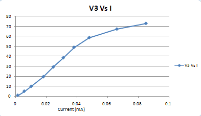

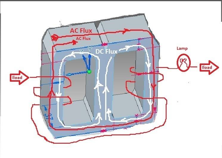

There was next-to-no AC put on the centre leg, about 0.007 VAC wasn't cancelled, I think the current through the centre winding was pretty steady.
As you can see from the graph I did get a small operating voltage across the mag Amp when there was a DC voltage of 15V, there was a voltage of 0.894V AC on the mag Amp.

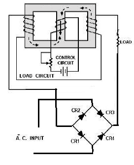

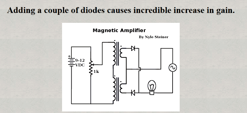

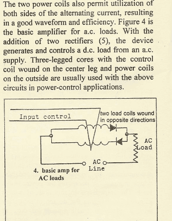

Sounds like you have an operating fig 8.
I'll take an idea from anyplace, academic or not.
Sparkbang had an operating fig8 too
looks like he just added diodes to make it self saturating
in this
EDIT (refer to post 120)
With that self saturating arrangement with diodes, post 120, your DC holds the cores "off" against the applied ac halfwave - zero current will i think be full on.
By driving the flux below zero before start of cycle, you control how many volt-seconds are required to reach saturation and collapse the impedance.
(my basics are slowly creeping back- i'd forgot the phrase "collapse the impedance" which for me was key to how they work.)
easy enough to try
with your youth, enthusiasm, and math skill so superior to mine , you'll fly past me very quickly.

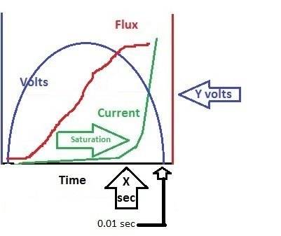

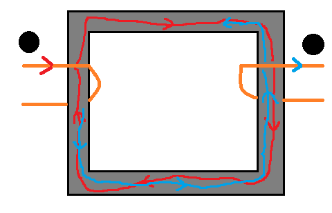

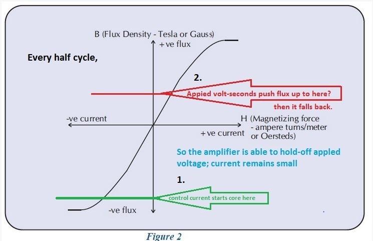

You asked how does the flux in a transformer work its way back to symmetry after an unfortunate energization at sinewave zero crossing.
I said i didnt have the words just then ,
well,
they came while i was at monday night poker.
But i still need a picture to convey the thought.

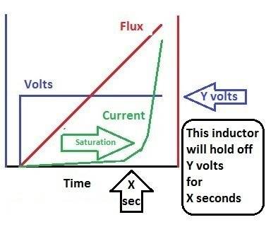

The reason is something you mentioned eons ago - voltage drop in primary winding resistance.
Go wayyyyyy back to our model of a transformer
XM is where we make flux
and voltage applied to XM determines what that flux must be ; flux must be integral of that voltage..
When we saturate we get increased current which lowers voltage EP that's applied to XM and the ideal transformer.
Ip X Rp is that drop
You'd think it'd be symmetric, eh ?
Take a closer look
Since we only saturate on one side of zero , that Ip Rp drop is asymmetrical. Lenz's law gets involved too.
As you know i like square and triangle waves because they make the integral-derivative relation so obvious.
So i marked up one of the earlier ones . It was for ideal transformer, and i added influence if primary resistance to it in chartreuse.
Pardon my awkward drawing, I'm a total klutz.
I hope this picture is worth a few hundred words at least...
Observe when core starts to saturate, voltage applied to XM droops a bit because of drop across RP.
That rounds off the corner of the wave as shown by my chartreuse curve.
When the applied square wave voltage flips negative...
XM , obeying Lenz's Law, also flips polarity to maintain current.
KVL says now voltage across XM must be larger than Vsupply instead of smaller,
so that bottom corner of the square wave gets its corner not rounded but spiked - see my chartreuse "pointy" in sketch above.
So what dos that do to the volt-seconds applied to XM ? It obviously makes the areas above and below zero unequal and in the direction to drive flux back toward zero centered.
The key is Lenz flips polarity of induced voltage but IR drop doesn't flip polarity,
so we have
Ep = Vsupply - IpRp in the positive half cycle
but
Ep = Vsupply + IpRp in the negative half cycle
so - Mother Nature, Calculus, Lenz, Kirchoff , Steinmetz and Tesla all conspired to make transformers that work well..
I wasn't too far off when i said the energy in the DC magnetic field gets dissipated in the winding resistance, and the numbers might work out that way i don't know .
My point is - armed with these simple models we can figure out what is happening, and from there we can figure out the equations.Transformers are cool, eh ?

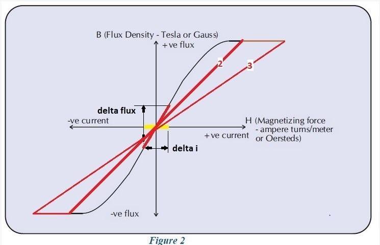

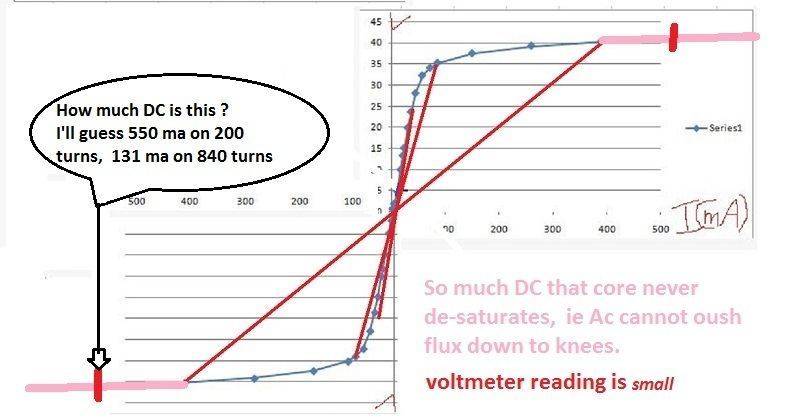

Had a thought on magamp BH curves too.
I think you can look at an operating magamp as a triangle on the BH curve.
Need to work on words, though...
Here's one pretty well turned "ON"
and this one's pretty well "OFF"
so if your data has AC volts and AC current readings
see if you can figure out a graphical solution - you've already graphed BH curve for your core . Do your datapoints have AC voltage and AC current readings ?

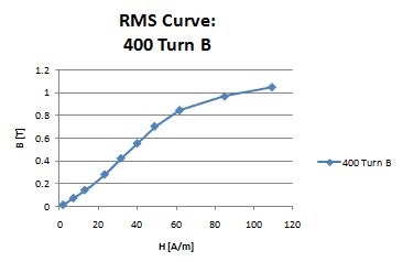

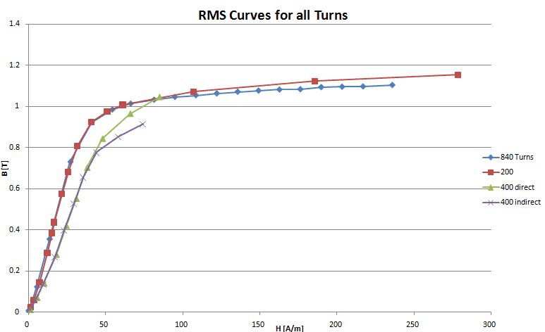

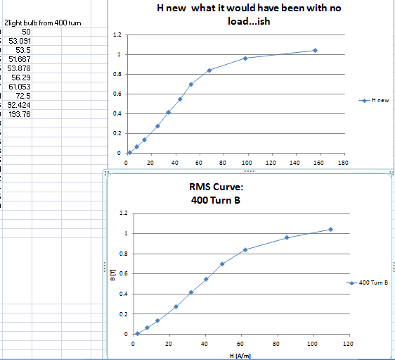

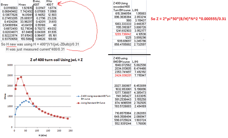

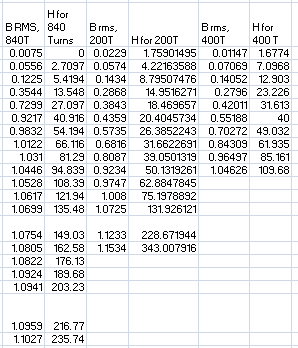

1. So what did you think permiability μ of my core might be? (I assume the value they usually talk about is μ at the knee)
I looked up AL (from your chart, the one with the 'nh' mystry terms) which is apparently the 'inductance factor'. But I'm still none the wiser as to how or what those terms are in relation to the inductance factor.
Edited : 2. That conflict in the new model we're talking about here for ideal inductance and the formula I usually think of : L = μN2A/Length = N2/Reluctance
(It is really the reluctance part that makes me question, N2 /Reluctance; because as we established there's a sweet spot where μ is biggest, because if the area A gets too big we start sliding back down the curve, but that doesn't seem to agree with the right side of the equation (N2 /Reluctance) because it would seem like the denominator would just keep dropping, increasing the inductance. Ok so when you look at the curve you can see Φ/I at each point and see that it is biggest when the curve is steepest. You stated that it was 'flux linkage per Amp' we could judge our inductance on the curve by. My problem here: at first glance to me these equations seem to say 'the bigger/more the better' as far as inductance goes, which is what I used to think, but that is contrary to aforementioned 'sweet-spot' at the maximum gradient of the curve. Because I can imagine that L = μN2A/Length where 'A' and or 'N' are increased, that μ drops faster than they collectively rise (after the steepest point) however on the right side, N2 and or 'reluctance' is going up and down respectively, so they are indicating that the bigger the better the inductance, not like the balancing act on the left side.
3. Did you have a 'take' on what would happen to the dΦ/dt and inductance of the figures in post #116 compared to a non-rectified standard AC input?
Thanks heaps!
EDIT:
(4. Was there an easy demonstration of what the shape difference in current from increasing the secondary current heaps to a TX? OR current increase through saturating the inductor, which I think I am familiar with now, through your illustrations.)
5. Sorry could you explain again the difference between Volt seconds and volt seconds per turn? I've forgotten and I can't find the context, so V.s (Wb) is flux and you can have a steel that you (if you're the magnetics guy) can give a rated V.s for the knee point of (irrespective of flux density), which was what we found.
6. Sorry I know that's already a lot, but I Might as well add the reminder of:
tim9000 said:
So when designing for maximum inductance I need to know the...is it the Volt-seconds, (or volt-seconds per turn?) For a given AC excitation voltage that will give me the steepest point on the BH curve for that particular steel, then design the cross-sec area to be at that point (maximum change in flux per Amp) on the curve for the excitation AC, when the DC voltage is zero. Then I can have full reign over the possible inductive-spectrum for my mag Amp?
EDIT: This is tricky in my head because I always sort of thought, the bigger the core was and the more turns you wrapped around it, the bigger the inductance, but if you wrap too many turns around it you start to move the operating point away from the steepest point on the curve and the inductance actually starts to drop. So it's like you're operating point is defined by the material (μ) and to get to that point for a given voltage you need to design the core size so the area isn't too big or too small.
tim9000 said:
would that be 0.0097 T after the mm correction?
So what did you think the permeability of the core would be?

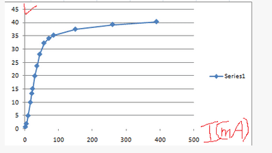

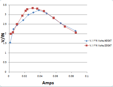

P.S Yeah my data should be all the voltages and current readings we hopefully will need, including the chart points.
  • #125

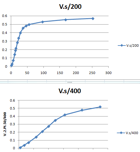

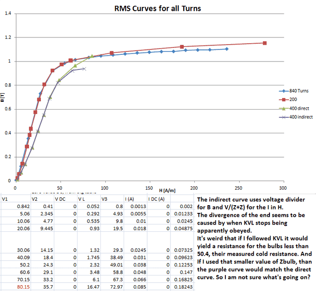

To Append point number 1. in my previous post:
I had been trying to calculate μpeak from the 840 turn leg before, and I thought I was getting a nonsense result, but I actually think it might be correct, what do you think:
Peak μrelative = 0.7 Tesla / (840 turns * 10mA * 4π*10-7) = 66,3146
Off to bed now I think
  • #126
too much for me all at once.
Plus WinTenTin has decided to turn off spellcheck so this is death by a thousand stings.
no length anywhere in there ?
Φ = μ μ0 N I A / L
Φ/A = μ μ0 N I / L = B
μ = BL / ( μ0 N I )
I think we need to get this core working better in your head.

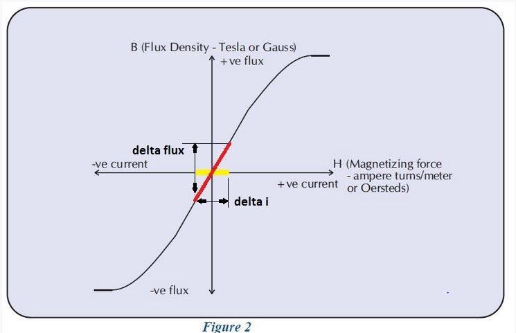

I do better with pictures. That's why i mentioned graphical solution.
tim9000 said:
What solution are you tasking me to?

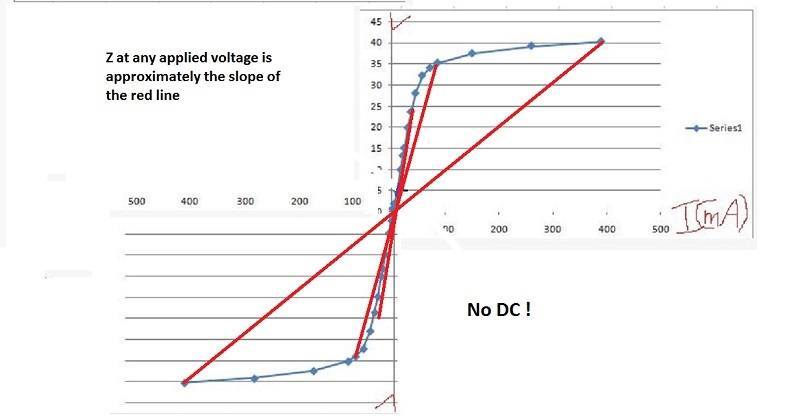

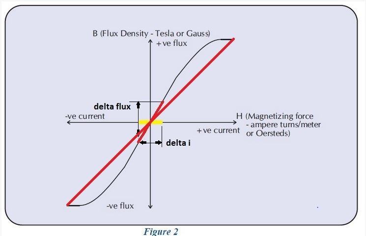

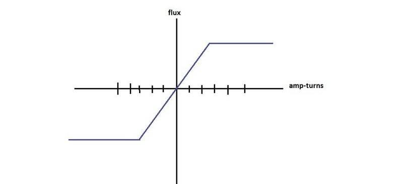

Envision your operating locus on the 2-quadrant excitation curve.
Then from your measurements, draw it on the curve.
You doubtless have numbers written down, i'll have to extrapolate them from the graph

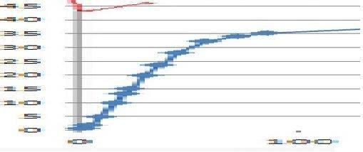

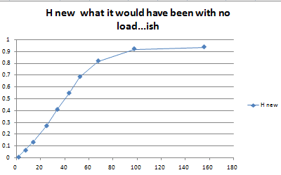

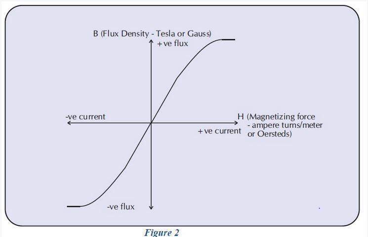

Let us take your AC excitation curve from post 86 and make it two quadrant so it resembles a DC BH curve.
With no DC present, applying let us say 15 volts to both outer legs of your core gives us what, 20 milliamps ?
Now with the two quadrant graph we can imagine current sweeping negative and positive 20 ma at line frequency, and voltage sweeping positive and negative 15..
I'll make current green, voltage red.

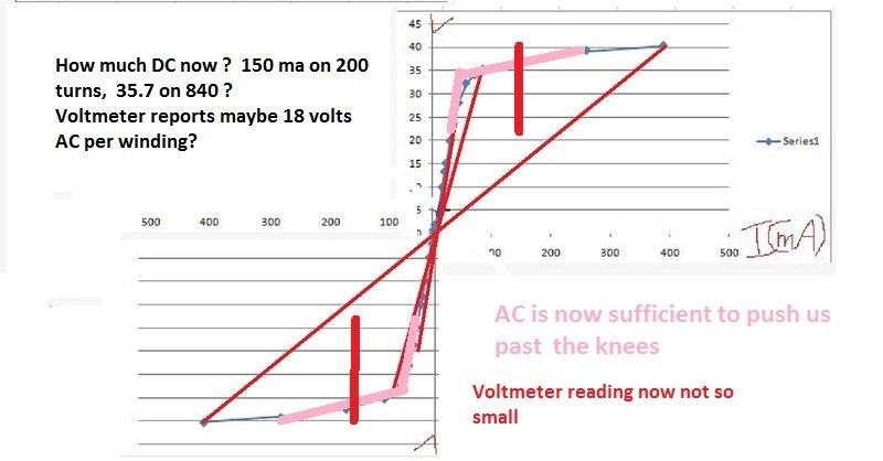

Now let's add some DC to your center winding, leave outer ones alone.
That's the same as adding a DC component to your outer leg excitation voltage, is it not ?
So your operating point shifts.
observe the same AC voltage let's through a lot more current.
But - there's a load in series
so the magamp will drop less of the supply voltage, and the load more.
I'd be curious if the voltages across your two outboard coils remain equal to one another.
As you observed in your post # 107
Won't the voltage across and current through your coils tell you where you're sitting on the BH curve ??2am here , off to bed for me.

No, I forgot that; I just used μr = [B/NI] /4piE-7
used the B you calculated (0.7T) and said H = 840*10mA, forgetting the length term (Also, I might have forgotten the decimal point before the last digit (the 6) :-| )
SO, say the length is about 95 + 16.5mm:
It should approximately be μr = [0.7/(840*10*10-3/(0.095+0.0165))] /4piE-7
=7,394, owch! that's low.

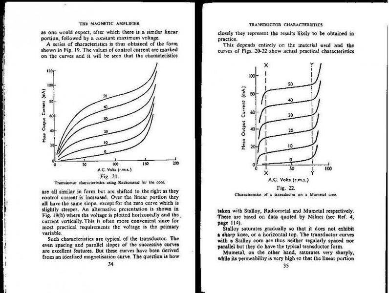

That picture explains a jolly lot! Yes about 20mA is about right. That is a fantastic way of thinking about it, with a 'but'.

I suppose when you put it like that, so the magnitude of the green vector plus the current that was flowing at zero DC, is the amount of how much RMS current I'm pushing through the mag amp to the load. That really is fantastic, but I think there's a translation between DC current which would be on the top graph and the green current you drew on the bottom graph.
To my way of thinking, you'd have say an offset of 40mA on the top graph, which would result in the red vertical line, and where that red line intersects the curve, that is the operating point in the outter legs too. I'll elaborate:

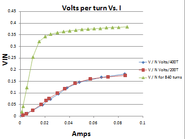

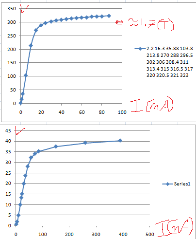

jim hardy said:

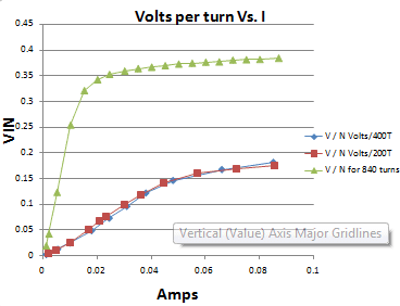

bottom curve 35 volts in 200 turns on 555mm^2 ?
.17 volts per turn ?
what do you get for flux?
.17/100pi = 5.4E-4 weber/555E-6m^2 = .97 T
Are both those curves the same? Just scaled? (like H scaled by the amount of turns between centre leg and outer leg, and the different path lengths between centre leg and outer leg. And B scaled by the difference in cross sectional area) I had assumed they were the same curve, as a property of the steel but now I'm not sure.
When I tried to do the above I get:
0.175/(100π*555*10-3) = 0.0018 T, at the knee of the outer leg, shouldnt' it be 0.7?
Ok, just assuming the outter and centre legs have the same curve, and we're putting 15V AC excitation on the mag Amp's outter coils, we then have 20mA through the mag amp with zero DC on the centre.
So the outer leg offset is that shifted from the existing current the curve was at, or from zero, (including the yellow line I drew)? I'm assuming it is from the curve itself and not from zero (i.e. how you had previously drawn it).
So the point from 40mA DC on the right translates into the point where the red line intersects the curve on the left (same part of the curve), and you come down that red line and go across the the curve where your 15V AC is and the length of the green vector is something like 200mA - 20mA, and the total current through the mag Amp is something like 200mA?
I could see it was saturating, but I wasn't sure how to think about exactly where I was sitting.
I'm quite confident the coils have about the same voltage, I took the voltage of one outside coil (V2), say for 50VAC applied, from 0 to 15 V DC on centre:
24.3V
0.769V
0.524V
0.435V
0.367V
and the whole mag Amp (V3 over both coils):
49.01V
1.575V
1.109V
0.915V
0.775V
so they seem about even, if that's what you meant about them being equal.

I made this curve in paint by just copy, flip and rotate your AC curve then paste them together
wanted you to think in terms of a DC curve, sweeping independent variable back and forth,
at first symmetric about zero current
then symmetric about some DC offset because that's what is going on in your magamp.
Here i tried to draw a voltage swing of +/- 15 volts (i was shooting for 10 volts rms but lacked resolution of the graph, call it 10 or 11 volts ?)
and to see how much current the magamp allows to flow
and it looked to me like maybe 20 ma
then by shifting the outside legs from zero centered to some point up the BH curve(coulda gone down, won't matter) ,
Whether i made that shift by adding DC to my excitation voltage
or by pushing DC flux into outer legs via DC on center winding is immaterial
so i don't see the need of your center leg curve above - maybe you copied that while i was still trying to get my images squared away,
(WinTenTin gave me fits so I'm back on 7 now)
my point was
adding DC moves you to a part of the curve where sweeping current gives you less counter-EMF so the magamp's impedance collapses
and that's how magamps work
and i think that clicked with you.
Now I'm wondering how flux flows around your core
Since your outside leg AC voltages add, your AC flux doubtless circulates around outside
and since you measured virtually no AC on center leg, AC flux must bypass center leg, which is not surprising since the mmfs of outside leg windings are at the instant i pictured one up and one down so they cancel.
but center leg's DC MMF pushes both outer legs into saturation region.
Observe that in outer legs,
DC MMF opposes AC MMF for half of every AC cycle
and i think that's why the self saturating magamp has so much more gain, its diodes relieve that tug of war. But that's for later on.
But - it's why i was curious about DC components in voltage or current.

looks to me like you'd call it offset from zero. The BH curve is zero centered .
My lines just tried to show where we are operating the device.

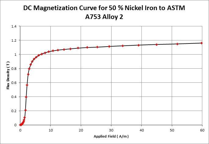

Where was i going ? Probably to try an estimate of your core's relative permeability.
Do you have a published number for it ? Look carefully and see if they give two numbers, one for DC and one for line frequency.
nh/t^2 i am petty sure is nanohenries per turn squared and i remember it as being a clever shortcut
I'd assumed the mag amp had heaps of gain (or MMF atleast) because you could wrap as many turns around the control leg as you wanted and you didn't have to worry about inductance because it was DC. Yeah you'll have to elaborate on the gain from the diodes, what are you defining 'gain' as? I didn't really understand how the diodes improved the gain of the diagram you posted in #121 with this tug of war business:
jim hardy said:
With that self saturating arrangement with diodes, post 120, your DC holds the cores "off" against the applied ac halfwave - zero current will i think be full on. By driving the flux below zero before start of cycle, you control how many volt-seconds are required to reach saturation and collapse the impedance.(my basics are slowly creeping back- i'd forgot the phrase "collapse the impedance" which for me was key to how they work.)
Is there any actual need for the centre leg to be double the Area of the outside legs, what would happen if they were uniform?I think I understand that when you put DC on the centre leg you're shifting the operating point on the BH curve for the outer legs by some offset What I was trying to show here (with a few corrections), is that you can only see where that DC current (say you're putting in 40mA) is going to take the flux on the centre leg curve (orange line). You find that value of B on your 4 quadrant hysteresis curve (by virtue of both the curves being 'at heart' the same), find the value of the current to get the that B (red X on curve, say 200mA), and the current for the excitation voltage (say 15V) when there is zero DC for an outside leg is the AC oscillation on the offset operating point (yellow region say +/- 20mA to the offset):
Is that fair to say? So the current put through the mag amp to the load when there is a DC applied to the centre leg will be (200mA + 20mA /√2 )? And the impedance collapse will mean that there is verry little back emf voltage on the Amp, meaning almost all the power is now being used in the load. So what I'm getting at is, is this a good way to calculate from applied DC current, how much AC current we're going to be able to push through the mag amp?
Speaking of, what did you think of:

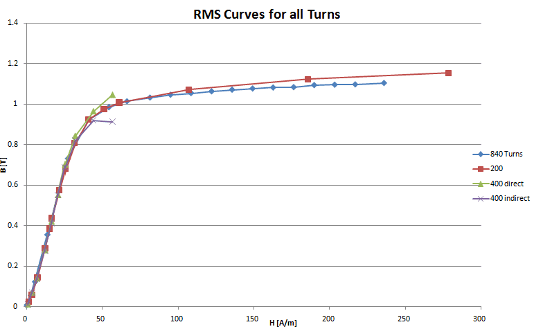

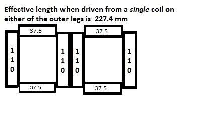

tim9000 said:
Sorry, I meant the curve I recorded for the centre leg, and the curve I recorded for the outside legs. They should be the same curve at heart, but scaled shouldn't they?
yes, same at heart.
Scaled for number of turns and core area.

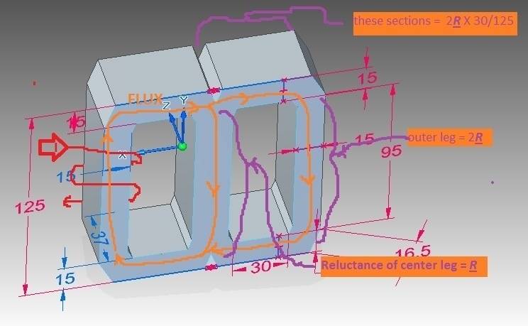

Is cross section of center leg twice that of outside legs ? I assumed so .
So center leg excited by itself has area of X,
but a single outside leg excited by itself has a longer magnetic path with segments of a couple different cross sections. Smallest cross section will saturate first. If both are excited together aiding so as to leave center leg essentiallly zero, you have uniform cross section around the outside loop.
well think about how the DC saturates the core. If center leg is to pass enough flux to saturate both outside legs, mustn't center leg have cross section area equal to total of both outside legs ?
Everything saturates in the neighborhood of a Tesla, but Tesla is flux density:: flux/area.
outside legs are 15 X 37 millimeters = .000555 sq meters, so 1 tesla = .000555 webers
The DC flux coming down the outside legs returns up the center leg so it should carry .000555 X 2 = .00111webers
and to carry that much flux without saturating, center leg needs area equal to .00111 m^2, sum of two outside legs.
Your AC curves show outside legs reach saturation at about 4X the current that saturated center leg
and they have about 1/4 the number of turns
so that's consistent
center leg gave 0.253 volts per turn
outers gave 0.17 volts per turn
0.253/.017 edit - oops, 0.17 is a ratio of 1.49
inferring either center leg carries 1.49 X as much flux as outers?
i don't see its thickness on your sketch so don't know its area. 1.49 X thickness of outer legs is 22.3 mm.
what's DC resistance of the windings ? Is IR drop negligible compared to AC induced voltage? Could that make volts per turn ou outer legs appear high ? Or do you think the center leg's turns only encircle 1.49X as much flux as outer leg ones ?

What I was trying to show here (with a few corrections), is that you can only see where that DC current is going to take the flux on the centre leg curve (orange line).
i wondered about that - horizontal axis on that graph is AC amps not DC, so I'm wary about the accuracy, but the logic is sound.
tim9000 said:
You find that value of B on your 4 quadrant hysteresis curve,
okay stop right there.
You have a system consisting of the magamp and its load, assume fixed supply.
You cannot define three things at once. One is the ratio(or some function) of the other two, define two and the third falls out by arithmetic.
You have now only identified a point on the operating curve of that core.
The slope at that point tells you how many volts per milliamp the magamp winding will develop at that operating point..
Volts/current = ohms
so you have a series circuit a loop consisting of Vsupply in series with Z of load and Z of magamp.
now you can calculate expected current in the loop and expected volts across the magamp by ohm's law

That was this curve of yours from post 107
wish you'd plotted DC current through those 840 turns rather than volts across them.
The height of your red mark here
will be the volts on your VDC & V3 curve just above.
The width of your yellow mark will be the current through load and magamp's outer legs.
horizontal lines from top and bottom of red mark ought to intersect the curve at ends of yellow mark
so you see, like they said the magamp is an adjustable impedance
and it's probably nonlinear when operated in vicinity of the knee.
I thought "Wow that's more reasonable, though i'd expect lower yet unless it's some exotic high-mu alloy ."
And i thought "i'll try to calculate a number when i get caught up"
Take out the center leg and try calculating volts per turn for air core with both windings energized
relative permeability at 50 hz is that number divided into your measured volts per turn, below the knee.

Tug of war
observe that as AC current reverses direction, it alternately aids and opposes flux in each outer leg
so i expected some AC voltage to be induced into the center leg
and in that textbook i cited they describe adding a choke in series with control winding to prevent that AC voltage from modulating control current.
So i was surprised by your reading almost no AC on center winding.
Yes you're quite right, and you've just highlited a mistake in my computer generated sketch of the core, the un-numbered width of the core should be 30mm, which it looks to be smaller in the 3D graphic I drew. So the area should be around as you say:

0.253/.017 is a ratio of 1.49
?? Also, how are you getting near 1T for the outer leg, when I do it I get:
0.175/(100π*555*10-3) = 0.0018 T, at the knee of the outer leg, so shouldnt' it be 0.7? Where am I going wrong?
is the volts on your VDC & V3 curve just above.
Well we should be able to determine the current through the 840 turns, because we have the voltage and the resistance of the turns was 10.7 Ohms.
The resistance of the outter windings were 0.835 Ohms each leg.
So you thougth it was too high? I thought it was too low. It wasn't amazing steel I was using, just reasonable transformer steel I'd have thought. as I said 'M4 grain oriented silicon steel', whatever 'M4' means...?
Ah, yeah I was impressed. Interesting thought to add a choke though. How does that tug-o-war get affected by a diode though?

i don't know why we got a ratio of 1.49 instead of 2 for center leg vs outer legs driven.
Maybe i;m not reading the graph well? Can you see at what currents you got 2X volts per turn ?

I'd say the knee was actually at 297V, so:
a = 297/840 = 0.35357
b = 35/200 = 0.175
acentre length/ban outer length = 2.02
So the ratio of the 'rate of change of encircled flux' is = 2, so how do we know this directly relates to the actual amount of flux ratio between lengths?
  • #137

i assume you meant legs ?
Thanks !
are you asking how we know relation between dΦ/dt and Φ ?
Oh come now, those are AC readings and we've assumed sine function..
remember waaaaayyy back when , we established that volts per turn is a measure of flux.
Thanks for establishing that volts per turn came out same ratio as core area, that gives more confidence in the experiment.
from posts 103 and 104
your -3 should be -6, millimeters2
and when i plug { 0.175/(100π*555*10-6) } into windows calculator i get 1.00369, just call it 1.0
that knee looks like a tesla to me
whn i plug

Flux will wobble about the DC point on the BH curve
Push to the limit - at complete saturation the current is determined by Vsupply/Zload, let's say RMS as radon your meter
and now i see the error of my ways in earlier attempts...
yellow line has width Vsupply / Zload X 2√2
but flux is offset because of DC from control winding
so we can move it over here
and ends of yellow intersect our volts/amps curve, showing us what will be voltage swing across magamp - just a volt or so , not smallness of red line
slope of blue line is Z magamp
and we slide operating point from steep slope to almost no slope by DC on control winding.
That's a saturable reactor , which is the basic form of a magamp.
  • #140
ahh maybe this helps make it step by step
at some assumed load current
at zero DC offset your magamp would've eaten up 35 volts at that load current
leaving Vsupply - 35 across load
but with DC , practically all Vsupply is across load
you know that, though...

First off, I can see you're saying that the height of your red triangle (the change in slope height) is the voltage on the amp, the length of the triangle (the change in current) is the current through the amp, and the hypotenuse of the triangle (the change in slope, derivative) is the impedance of the amp, I'll run with that for this post, but can you elaborate on why that is so?
I feel another nice trick coming on, ok so let's have a crack at this:
so d(the amount of sineusoidal flux )/dt = 2xsineusoidal function (like cos)

The mag amp impeance collapses to have a mean of Z mean = (40V-38V)/(360mA-240mA) = j16.7 Ohm, roughly taking your picture as an example.
Say the bulbs were 50Ohm. Meaning the total current through the mag amp is = Vsource / (j16.7 + 50)
That's a lot of reactive power, surely the voltage on the amp would've been more than 35V at zero DC, so there would be a tiny amount of current going through the load, and almost no voltage on the load?So if volts/turn is 'rate of chage of encircled flux, and volt*seconds is proportional B, but Bpeak = V/ANw, is volt*seconds/turn ever actually used to indicate anything?
Thanks again Jim!
  • #142
Δvolts/Δamps = Z
so the actual amount of flux = 2x sineusoid / 2πf
d(sinwt)/dx = wcoswt
∫sinwt = -1/w coswt
w=2Πf
tim9000 said:
Sorry, what's the x2 from?
RMS to peak-to-peak
tim9000 said:
Stop me if I'm incorrect, but I don't see how its the same load current: The magnitude of the yellow load current on the left will be smaller because (say the light bulb is 'R' constant Ohms) the impedance of the amp hasn't collapsed yet and is very big. The load current on the right will be larger because that is after the amp impedance collapse.
ahhh progress
yes your amp operates on a load line
when it's off, it feels full supply voltage
when it's on it feels supply voltage minus what's dropped across load
so rather than assuming a current we should be finding current and voltage from that relationship
called a "load line"
and seeing where the triangle thus defined matche our BH curve
wow wer'e making progress
please understand it takes me quite a while to digest a question then figure out an answer that sounds both logical and easy to grasp..
Right now my mind is hung on the point that your magamp must have enough core to hold off volt-seconds for chosen supply voltage and frequency
volt-seconds per turn defines a core's flux capability
volt seconds defines the ability of a winding on a core to not saturate when asked to block current
we've moved into sinewaves, but i hope that DC drill i put you through has helped with the concepts.

And since we've moved into sinewaves we have to ask ourselves what happens when the sinewave pushes us back and forth across the BH knee...

jim hardy said:
Δvolts/Δamps = Z
Just humour me, but why not: volts/amps = Z, as usual, wat was your reasoning behind the deltas?
err...say you were taking one 4 quadrant BH curve for the whole core, then wouldn't one outer leg be wobbling around the top quadrant DC offset saturted point, and the other be wobbling around the bottom quadrant DC offset saturated point?
back to the picture
were we using this one ?
or this one ?
Perhaps i should have gone back to a BH curve instead of the volts-amps curve. That would have been rigorous, and shame on me I'm the one who espouses rigor. But i get soooo frustrated with paint.
In either one,
what is the impedance of the magamp ?
Remember - the DC offset is because of the current in the control winding , not the load current
so the voltage across the magamp is however far the blue volts curve extends vertically over the span of applied current.
We introduced external load which limits current according tot he load line - and that's a key difference from previous thought experiments.
So, in top picture current is maybe 110 ma peak to peak, NOT the 290 average including DC offset. That DC offset comes from a different current in a different winding and just displaces us on the BH curve.
And voltage is maybe 2 volts peak to peak
so magamp's impedance way out there past the knee is V/I = 2volts /0.11amp = 18 ohms ?
Bottom picture 7 volts / 320milliamps = 21.9 ohms ?
So the root trouble is we're using the volts-amps curve for a BH curve and confusing ourselves. Too many thought steps at once. I hear Lavoisier saying "tsk tsk".
I'll cook up a simplified BH curve from your data.
Here's one we looked at way back.
It's a DC curve
so we have to imagine current sweeping horizontal at line frequency
and flux following current along the curve
and vertical distance travrsed by flux is dΦ/dt which is volts per turn
Did we get over that hump ?
  • #148
jim hardy said:
back to the picture
I was thinking this one:
jim hardy said:
  • #149
From your post 141
you were addressing this picture from my 140 ?
if so you are quite right about DC offset making impedance go small and load current go up. That's what we covered in 139.
Perhaps a sloppy drawing on my part, or a senior moment.
I think i was just trying to reiterate that voltage shifts between the load and the magamp .
Okay now i have to re-orient , what's next ?
old jim
  • #150
aha we crossed in the mail again
did i clarify ?
