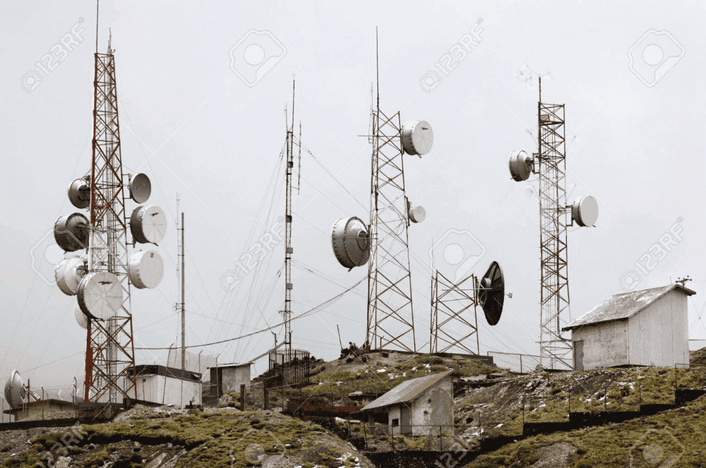

Not for 100 miles through a town. Buildings contain metal, which reflects and diffracts EM waves. Those redirections of the EM waves cause multipath interference at receivers, which significantly reduce performance and path/channel distance. Even when the obstructions are just trees and foliage, you will still get a lot of attenuation of the signal due to partial absorption (depending on the frequency of the EM being used).
Think about what existing 100 mile radio links look like. The antenna towers are on high hills, so they have line of sight to other towers on other hills. The highly directional antennas are aimed very precisely at their twin antenna on the other tower that they are linked to.
https://previews.123rf.com/images/a...tion-antennas-on-a-mountaintop-in-ecuador.jpg

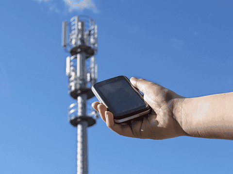

And think about cell phone towers, which do communicate "in towns". Note how closely they are usually spaced together (less than a mile), and how tall they are to try to get good coverage despite foliage attenuation and building multipath issues...
