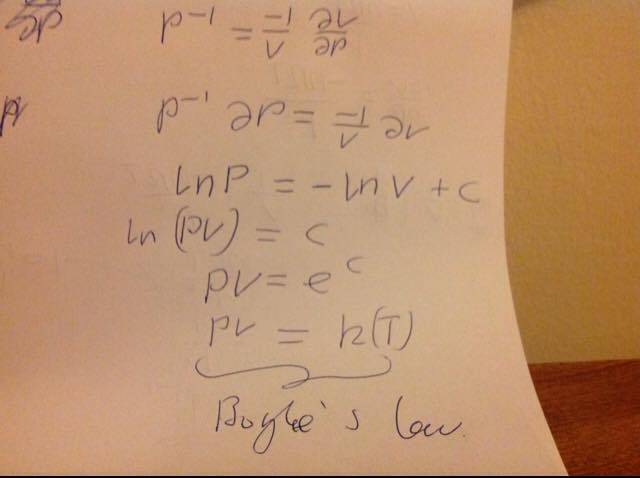

Does anyone know how to do question 6b)? Its a past paper question for an exam in 2 days and i have literally no idea where to start.
κT ≡ -(1/V)(∂V/∂P)T is given as the definition of isothermal compressibility. You've also been given κT = P-1. Substitute and integrate.

I tried that but I'm not getting anywhere. do you know how to do it?
Do you know what Boyle's law is? That's where you're trying to go with the integration.

Handwritten derivation on lined paper: p^-1 dp = -1/v dv, then ln P = -ln v + c, ln(pv) = c, pv = e^c, pv = f(T), with a brace labelled Boyle's law.
is this right?
Bystander said:
Very good. Good luck with the exam.
