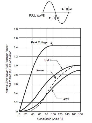

Hi,
In a system that uses a triac to switch mains voltage, how can one calculate the resultant peak voltage, RMS voltage and power for a given phase (conduction) angle e.g. 50°?

I think that equation for RMS voltage across the load look like this:
[tex]V_{load} = Vpeak *\sqrt{\frac{2 \pi - 2 \varphi + sin2 \varphi}{4\pi}}[/tex]
Where [tex]\varphi - triac- angle- delay = triggering -angle[/tex] .
[tex]for-0\varphi - triac- is- full- on[/tex] .[tex]And for- \frac{\pi}{2} V_{load} = Vpeak/2[/tex] .
Or use this graph
Top: a full sine wave with conduction angle theta marked on the leading and trailing portions. Bottom: graph of normal sine wave RMS voltage, power and average as fractions of full conduction against conduction angle 0 to 180 degrees.
http://educypedia.karadimov.info/library/an1003.pdf
I thought that I shows some example.
For V = 230V we have 325V peak and conduction angle 50° so the triggering angle must be equal to 130°.
Plot titled thyristor phase control showing a dotted sine wave with a solid conducting waveform: zero until a trigger at about 2.3 radians, then a pulse following the sine, and a negative half-cycle conducting from a trigger near 5.5 radians. Labels read RMS output (V) = 0.246, triggering angle (degrees) = 130, conduction angle (degrees) = 50.
First we must convert 130° degrees to radians:
r = 130 * ∏/180 = 130 * 0.0174 = 2.26 [rad]
I use Wolframalpha
http://www.wolframalpha.com/input/?i=sqr(+(2pi+-+2*2.26+++sin(2*2.26))/(4pi)+)
but you could use Google too
Code:
sqr( (2pi - 2*2.26 + sin(2*2.26))/(4pi) )
Vload = 325V * √ ( (2*pi - 2*r + sin(2r) ) / (4pi) ) = 325V * 0.249 = 80.9Vrms
