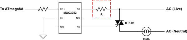

Disclaimer: Some of you might easily recognize that the components and circuit I am talking about are related to one of my projects, on which I had posted some months ago. Actually, the circuit is the same as the one in my project, but the one I am posting in this thread actually uses high voltage AC mains, so I am never going to implement it. This is just to satisfy my curiosity.
The schematic is given below:
As you can see, I am controlling the BT139 triac using the MOC3052 optoisolator. Both of them can handle high voltages. The circuit above is similar to the sample circuit shown in the datasheet of the opto. My question is, how do I calculate the value of R (boxed in red) in high voltages?
Say, I want to connect this Triac to my mains, which are at 220 V RMS, or 311 V peak. As per the datasheet, the opto can handle a maximum of 300 mW power dissipation at its detector. For safety, let's take a value of 250 mW. So, the peak current through the gate of the triac would be ##250~\text{mW} / 311~\text{V} = 0.8 \text{mA}##, and the value of ##R## would turn out to be ##311~\text{V} / 0.8 \text{mA} = 388.75~\mathrm{k\Omega}##. Using standard resistors, I can get ##330~\mathrm{k\Omega} + 47~\mathrm{k\Omega} + 10~\mathrm{k\Omega} + 1~\mathrm{k\Omega}##. Does this look sane?
Also, I had another question: what is the minimum gate trigger current (IG) required to switch on the triac? In the triac datasheet, the maximum IG is given as 2A, but nothing has been said about the minimum IG. If my above calculation is mathematically correct, will 0.8 mA be enough to turn on the triac?
This is all about the "gate trigger current" part of the datasheet, which is pretty well characterized. Note that when they specify the maximum value, they mean the value that is guaranteed to work, not a value that can't be exceeded. This is because it appears in the "characteristics" section, not the "limiting values" section (that value is "peak gate current". 0.8mA may very well be enough sometimes for some devices, but it's not enough for a good reliable design. You'll want something more like 35mA.

I had seen that portion, but couldn't really make out what they are trying to say. IT is probably the current through the triac, and Tj is the junction temperature. What does VD and T2+ G+ mean here? How can I translate the values to higher currents, like, say, 6A?
Hmm, that's where the problem lies. 35mA means 311 V * 35 mA ≈ 11 W, far higher than what the opto can handle. In fact, I haven't even seen this high power resistors. Then how do people use this Triac in high voltage circuits? Is there some other way to trigger the triac?

Vd is the voltage across the device from MT1 to MT2. T2+ G+ refers to the polarity of the trigger current w.r.t. the anode/cathode. It's described in the links below. Since you are triggering from the device voltage (thanks for posting a schematic, BTW) you are operating in the ++ or -- region for resistive loads.
I don't think you need to worry about that for triggering. The triac will turn on with low current anyway since it starts from 0, and once it is triggered it is on and will stay on regardless of how you drive the gate. It will only turn off when the current polarity switches (assuming you've removed the gate drive by then.
The conditions listed (like Vd=12V) are only there to tell you how they tested them for characterization and screening. It is up to you to figure out, based on general knowledge of the device type, how it might be different in your application.
Assuming the triac triggers reliably, the voltage across the driver is removed when the triac turns on. So the stress on the driver is removed. High voltage and high current shouldn't happen at the same time for the driver, it is a pulsed load. OTOH, if the triac doesn't trigger, then you may have a problem. I often see big gate resistors in thyristor circuits because of this. Although cheap consumer designs may just let the resistor or IC fry if the device isn't triggering, as long as it fails safely. You can also put a capacitor in parallel with the gate resistor to give the triac a current surge that then goes away, this is a common feature in higher power circuits to get the device on ASAP.

There are lots of solutions, but I like the IC you have chosen. Unless you find some limitation I would procced as you are.

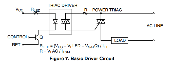

Thanks, @DaveE, for the really long explanation. I will go through the design guidelines you have linked. But one question: how do I choose a value of the resistor? In the datasheet of the opto, they have given a similar circuit, and said that R = VpAC / ITSM:
ITSM = 1A as per the datasheet, and VpAC is probably the peak AC voltage, so 311 V in my case. So, do I just put a resistance around 311 Ω without caring about the power dissipation? Will this be valid if I have to continuously switch the triac on and off based on zero crossing detection (to get a dimming effect)?

Yes, I would follow that advice. Because the triacs will (should) turn on there won't be much power dissipation. If the big triac fails open the gate resistor will have huge power applied and will also fail. So use a small one that won't cause much damage when it burns up. There are special "fusible resistors" that are designed to fail safely like this, but I think most people would just use a normal small resistor (1206, or 1/4W for example) and test it. The big triac is likely to fail shorted anyway, which will just turn on the load and remove the stress from the gate circuit. The failure mode of gate current but no anode current isn't the most likely.
As far as normal operation, you can calculate a worst case power dissipation in the gate resistor Like so:
Trigger current < 35mA
Turn on time < 5usec
Gate voltage <311V
Max frequency <60Hz
This gives a power dissipation of 3.3mW
Gate voltage <311V
Max frequency <60Hz
This is a reasonable and professional calculation.
In my case, this will be 10ms.
Wrichik Basu said:
Thanks once again, @DaveE.
No, this is the time it takes the triac to switch on. During this time the triac current is increasing and the triac voltage is dropping. It's listed on the data sheet at 5usec typical. Once the triac voltage switches to a volt or so the gate drive current is essentially removed, so there's no power dissipation in the resistor when the big triac is on or when the small triac is off.
Oh, yes, sorry. In my ATmega code I am actually turning on the opto for 10μs. I forgot that and wrote 10ms instead.
