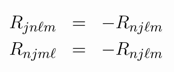

@Ibix Aren't there 36 in 4d Space. This condition shows that the all the components whose 1st and 2nd or 3rd 4th indices are equal must be zero. Therefore square of 4C2=36.
Bishal Banjara said:
But there are only six components listed both in the above document and in the MTW of which I have calculated only two those are different than what they should be. Am I wrong?
MTW says on page 821 that there are other non-zero components obtainable by symmetries of the Riemann. I'm not sure about the all-lower-index Riemann that they are using, but there are twelve non-zero components in the (1,3) form you seem to be using (although on a re-read I'm not certain you have the lower indices in the order I expected - I think what you've called ##R^t{}_{rtr}## is usually ##R^t{}_{rrt}##, although it's possible I've got lost in the different notations used by different sources).
If arranged in a 6 x 6 matrix, there are still 21 independent components.
e-pie said:
@Ibix Aren't there 36 in 4d Space. This condition shows that the all the components whose 1st and 2nd or 3rd 4th indices are equal must be zero. Therefore square of 4C2=36.View attachment 229214
Most of them are zero in the Schwarzschild metric. It's only the remaining ones we care about. And there are twenty independent components in general: http://mathworld.wolfram.com/RiemannTensor.html
