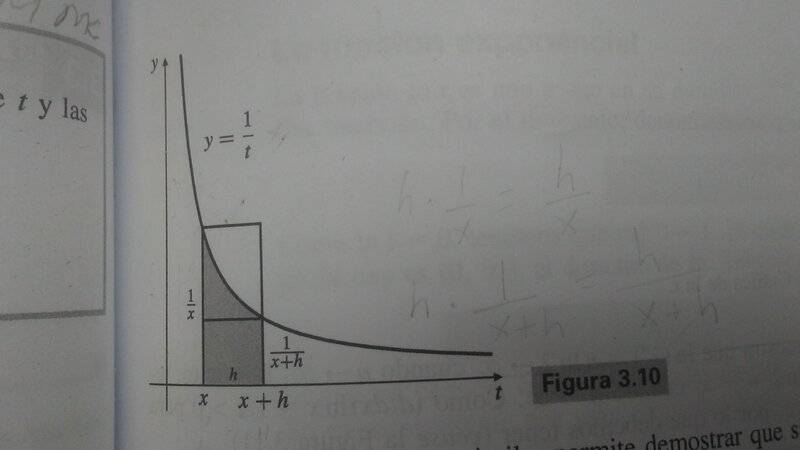

In my textbook, the Spanish 6th edition of "Calculus", by Robert A. Adams, at Chapter 3.2, Theorem 1 states:
If ##x>0##.
$$\dfrac{d}{dx}\ln{x}=\dfrac{1}{x}$$
PROOF For ##x>0## and ##h>0##, ##\ln{(x+h)}-\ln{(x)}## is the area of the shaded part (...) Regard the shaded area at Figure 3.10

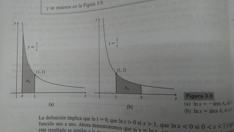

All of this is right. My question is: let's put I know nothing but what I've read until this page: could anybody conclude that ##\ln{(x+h)}-\ln{(x)}## is the area pointed out? As far as I know, the starting point is the Definition 6 of natural logarithm:
"For ##x>0##, be ##A_x## the flat area bounded by ##y=1/t##, the ##t## axis, ##t=1## and ##t=x##. Function ##\ln x## is defined this way:
$$\ln x=\begin{cases}{A_x}&\text{if}& x\geq{1}\\-A_x & \text{if}& 0<x<1\end{cases}$$
As shown in Figure 3.9
Greetings

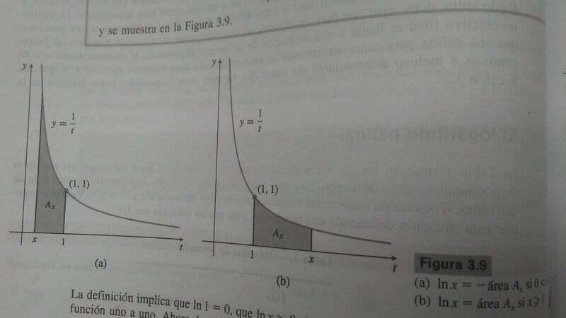

"DEFINITION 6 Natural logarithm
For ##x>0##, be ##A_x## the flat area bounded by the curve ##y=1/t##, the ##t## axis and ##t=1##, and ##t=x##. The function ##\ln x## is defined this way:
$$\ln x\begin{cases}{A_x}&\text{if}& x\geq{1}\\-A_x & \text{if}& 0<x<1\end{cases}$$
shown in this figure
(a)##\ln x=-\mbox{area}\;A_x##, if ##0<x<1##
(b)##\ln x=\mbox{area}\;A_x##, if ##x\geq{1}##
The definition implies ##\ln 1=0##; ##\ln x>0## if ##x>1##; ##\ln x<0## if ##0<x<1## and is a one-to-one function. Now we will prove that if ##y=\ln x##, then ##y'=1/x##. The proof of this result is similar to the proof of the Theorem Fundamental of Calculus (...)

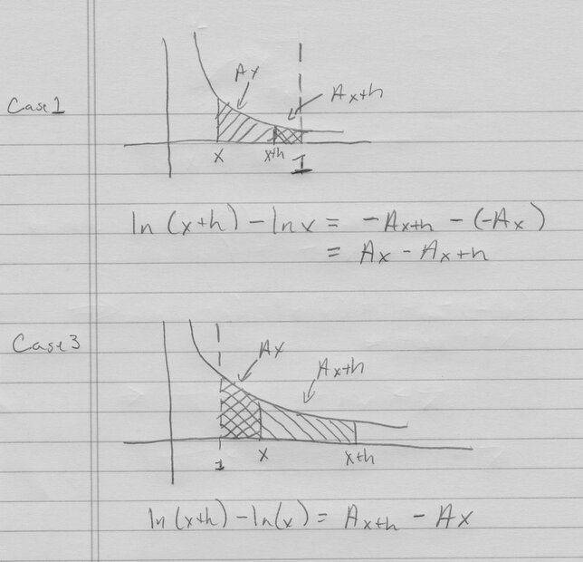

There are 3 cases (x,h are both greater than zero)
x<1,x+h<1
x<1,x+h≥1
x≥1,x+h≥1
Try drawing a picture for each of the cases of the areas under the 1/x curve from the definition of ln
x<1,x+h<1
x<1,x+h≥1
x≥1,x+h≥1

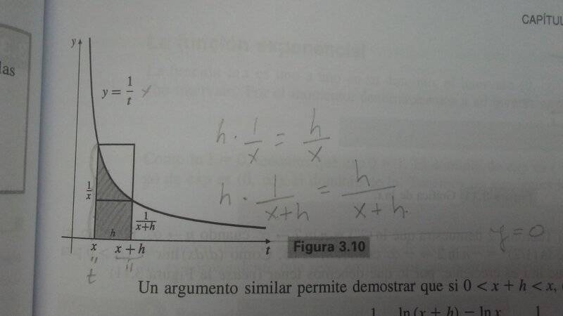

DEMONSTRATION For ##x>0## and ##h>0##, ##\ln(x+h)-\ln x## is the area of the flat surface bounded by ##y=1/t##, ##y=0##, and the vertical lines ##t=x## and ##t=x+h##. Belongs to the shaded area in Figure 3.10. Comparing this area with the one of the two rectangles it follows that
$$\dfrac{h}{h+x}<\mbox{shaded area}=\ln(x+h)-\ln x<\dfrac{h}{x}$$
(Then comes the well-known figure)...
The fact is that I'm not sure whether is it using Fundamental Theorem of Calculus or not, but I've done the homework (draw all the cases with Geogebra). Nothing works to conclude from the background that "For ##x>0## and ##h>0##, ##\ln(x+h)-\ln x## is the area of the flat surface bounded by ##y=1/t##, ##y=0##, and the vertical lines ##t=x## and ##t=x+h##", unless I say: ##\ln x## is a strictly increasing function. Then is trivial.

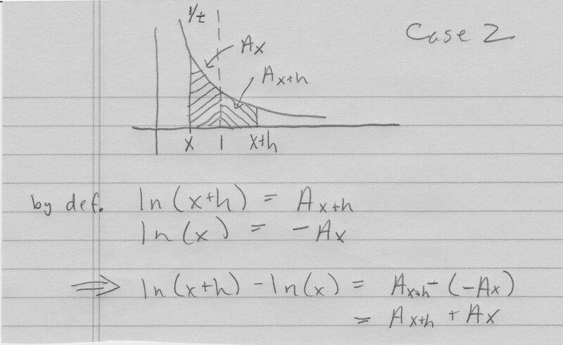

I have a meeting in 5 minutes, so I’ll give a hint and check back later
ln(x+h) is the area under 1/x from 1 to x+h
ln(x) is the negative of the area under 1/x from x to 1
What is the difference between them?
edit: for case 2
See picture
The other two cases are similar

I disagree. It works your example...Let me see... Please, forgive me...I must think it over.
Thanks! :smile:
I disagree with your disagreement. :-p
Notice that there is an overlap region in both of these cases
:doh: I have no words to express my gratitude.:partytime:. Thanks!
