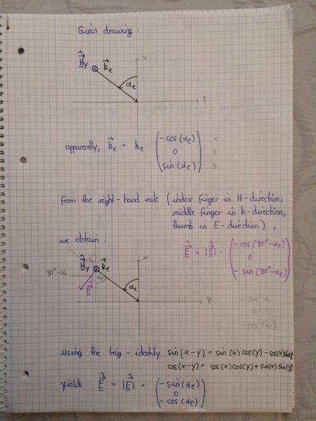

Ok. Well, here is my gemoetric solution and how I choose the cross product. I hope it is readable:
.. wait. How can I upload a photo ?
allright, should be uploaded. You find the images at the end of this page
So, what's confusing me is: This answer appears to be correct. But as you can see on the last page, the cross product of E x H does NOT yield a vector in k-direction, but in negative k-direction. So, WTF ?

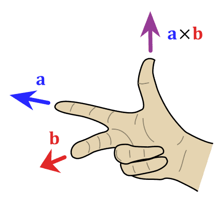

It seems you have applied the right hand rule incorrectly. If you use this definition of the rhr and your sketch, you should have index finger along E, middle finger along H then the thumb along k is opposite to what you have drawn. Now the directions of H and k are given, so you need to redraw your E-vector.
