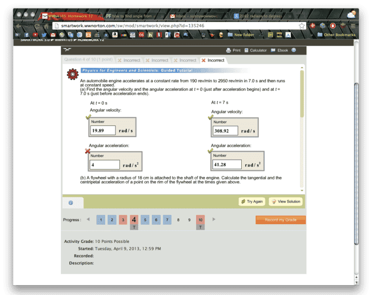

a)t=0 t=7
190/60*2pi=19.8 2950/60*2pi=308
308/7=41
I don't know what to do with acceleration with t=0.

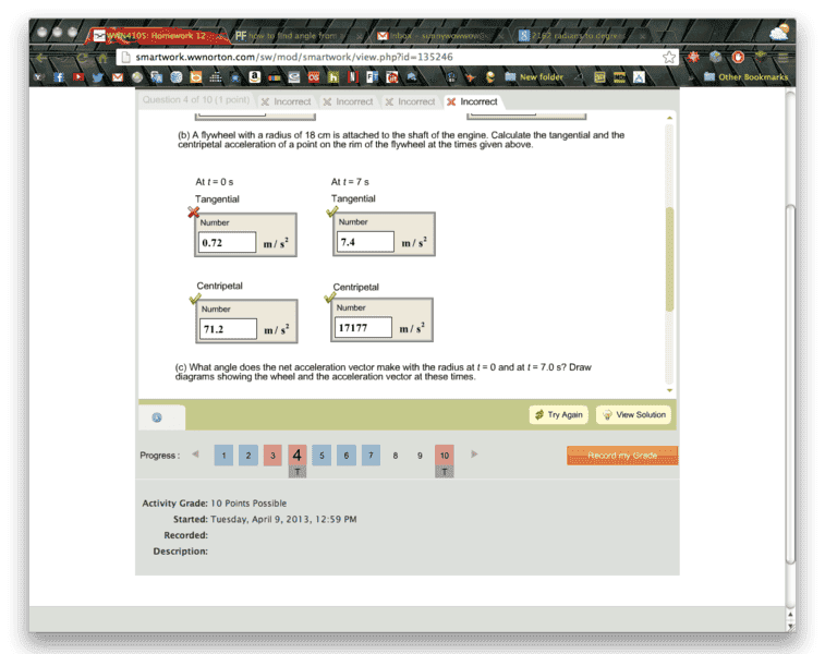

b)for tangental I used the equation alpha*R
for centripetal I used w^2*R
c) I think the equation might be applied
atan(atan/acen)

Sneakatone said:
a)t=0 t=7
308/7=41
You are told the acceleration is constant over the 7 seconds. The question asks for the acceleration at t=0+ε.
what do you mean? what does the E stand for?
It's epsilon, a fairly standard notation for an arbitrarily small (usually positive) quantity. In other words, it isn't asking for the acceleration exactly at t=0 (which would be impossible to determine) but the acceleration just a fraction later.
You are told the acceleration is constant over the 7 seconds, but that could mean over the interval [0, 7] or [0, 7) or (0, 7] or (0, 7). The point is that 0+ε lies in all of them, whereas 0 only lies in the first two.
so can I calculate the acceleration at 1 sec?
What's to calculate? The acceleration is constant, and you already know what it is .
so acceleration is the same being 41.28?
That's it.
I have part a and b
for part c I used atan(atan/acen) to find angle but its incorrect.
That's the right principle. Maybe you made an arithmetic error, or perhaps you need to consider that the radius, as a vector, points outwards, whereas the acceleration points somewhat inwards. (I.e., the centripetal acceleration is negative).
for t=0 I did 7.4(7.4/71.2)=0.76
t=7 7.4(7.4/17177)=0.0031
You seem to have confused yourself by an overloaded abbreviation. You wrote previously "atan(atan/acen)", which I interpreted as arctan(atan/acen), since that is correct, but in your numerical working you have interpreted it as atan(atan/acen)
so I am suppose tan-1(7.4/71.2) ?
Yes. Do you see why? Draw a right-angled triangle with the side opposite angle theta representing the tangential acceleration, 7.4, and the (non-hypotenuse) side adjacent representing the centripetal acceleration, 71.2. What would be the value of theta?
yes i do ,aslo my calculator was in radians at first so I got confused, Thanks for the help!
