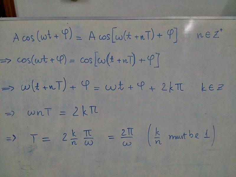

First of all, I just don't know how you can get ##\omega'=\sqrt{A\omega^{2}}##
You wrote ##a=-(\omega'^{2})x##, it's ok, but when you put ##x=A\cos(\omega t+\phi)## from above into this equation, how did you get ##\omega'=\sqrt{A\omega^{2}}## ?
Secondly, ##T=\frac{2\pi}{\omega}##, that's a definition, but if you still want to find out why ##T=\frac{2\pi}{\omega}##, you can look at my instruction below.
Here, ##k/n## must be 1 because ##T## is "period", it means that time ##T## must be a smallest number (and non-negative, of course)
p/s: sorry for my laziness, I think that writing on the board is faster than typing on the keyboard
