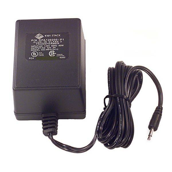

Welcome to the PF.
Just get a 12Vdc "wall wart" power supply. It already has the safety approvals, and they are relatively cheap.
Hello ylzxu and welocme to Physics Forums.
Do you realize that your batteries give 12V DC whilst the mains gives AC power?
Your LEDs will work from either but the voltages will be slightly different. You need 9V AC rather than 12 for the LEDs and to reduce the series resistor by 1.4 (divide by 1.4) to restore the current drawn to the same level and maintain the brightness.
Just to correct an oversight by Berkeman.
His text talks of a DC adapter, but the rating on the picture clearly states output : 12V AC.
You should check with your shop which one you are going to buy.
The 12V (DC) or 9V (AC) adapter is necessary to provide safety isolation between the mains and your circuit.

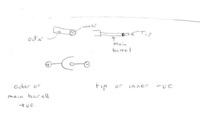

Thanks for the replies guys.
Sorry for the stupid question, but where would I connect the negative terminal of the series circuit? I know the positive terminal connects to the adapter.
Also, with regards to what you (Studiot) said, could you possibly explain what you mean by "restore the current drawn to the same level."
The connector on the output lead is usually ether the type shown in Berkeman's picture or the laptop/calculator type with a hollow barrel and metal on the inside and outside.
Either way the polarity of the connection should be marked on the plate of the adapter in as in the symbols on my (sorry it's so scruffy) sketch.
AC adapters don't have +ve and -negative and can be connected either way round so there is no polarity symbol on Berkeman's pic.
go well

Thanks for the catch, Studiot! I neglected to look closely at the picture I snagged from Google Images. Glad you were paying attention!
