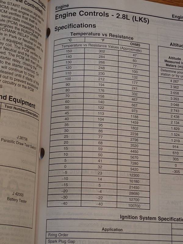

If it really is a thermistor, the factory service manual (FSM) should have some temperature vs resistance information. The FSM for my truck shows this for the coolant temperature sensor:
So, if it really is a thermistor temperature sensor, and if it is working properly, the resistance will be in a range that a normal multimeter can easily measure. Your reading of 0 to 1 ohm means that it is either not a thermistor or it has failed.
