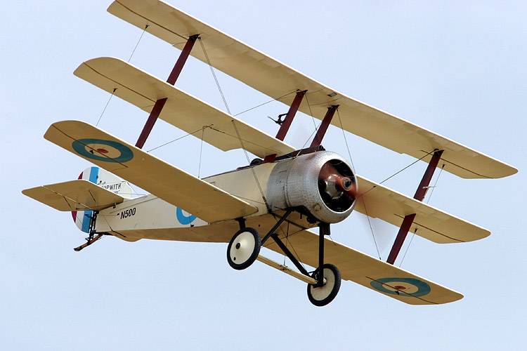

How about this?
http://www.airsceneuk.org.uk/airshow03/duxsept/triplane.jpg

berkeman said:
Welcome to the PF. :smile:
How about this?
I have said "without increasing wingspan" and you haven't noticed that part.

Of course I did. That's why I went "up" instead of "out"... :smile:

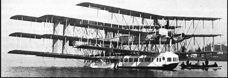

The OP said nothing about maintaining level flight, drag, or induced drag, so that opens possibilities. Flaps, leading edge slots, increase chord, lifting body fuselage. And more wings.

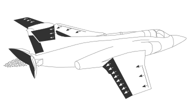

Since in this thread you seem to be asking for ways to increase the lift of a wing, and you have mentioned the Coandă effect, I'd assumed you meant the use of pressurized air to increase lift with blown flaps and similar techniques, as shown on the Buccanner aircraft above, and in this wikipedia article:
https://en.wikipedia.org/wiki/Blown_flap
