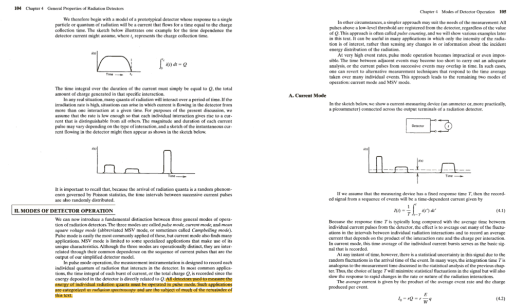

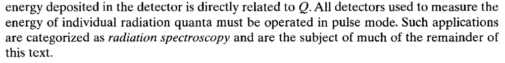

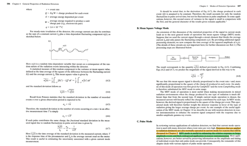

BvU said:
You sure you are asking about activity ? That's a counting rate, not an energy.
Exactly. That is the question. Since it's a counting rate I assume that it is not possible to measure it in current mode, but I'm not sure.
For example here are 4 pages taken from the book (I hope I can post them without problem)
and
As I understand the only way to measure activity in current mode is in the only particular case that the incoming particles are all known and at the same energy. But it is not explicitly stated in the book at any point, so I guess it's not the case or it is assumed obvious.
My hawkeye dsitinguished two blobs, one yellow -- before he talks about current mode
and one yellow-green -- after the section about current mode
I can't link these two to your
but maybe I misunderstand something.
In your post #1 you mention ionization chambers as the subject of this thread, i.e. no gas multiplication mechanisms and such (as with geiger counters and proptubes) but operating in the ion chamber region.
So there is a pulse height distribution that smears the current vs counting rate relationship. That doesn't disqualify the instrument for use as activity meter, it just reduces the accuracy -- most of the time only a little, and for many purposes not problematic. You mention "incoming particles are all known and at the same energy" but even then the energy loss process is a statistical process -- not to mention geometrical considerations if it's not a pencil beam of particles.
Your scenario in post #3 is realistic in the sense that you should realize that a single particle has to ionize quite a lot of gas molecules for a signal to be detectable (a picoampere is ##10^7## ions/s) and the total number of ionisations for alpha particles that stop in the chamber is probably roughly proportional to the kinetic energy.
However, not many sources have such a spread in energy that the relationship current-activity is completely lost.
