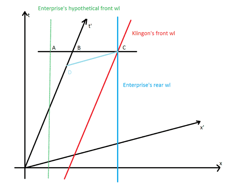

Similarly, I ask you, would it make sense to use the yellow markings along the t1 axis to measure the x1 distance between the bottom two events? Again, they are the same physical distance on the drawing.
English is not my preferred main language, even I use it every day for my job.
So I cannot understand the "mood" of your sentence just above. It seems a bit
you are doing some irony, but I'm not sure ( notice there's not any polemic in my words, I'm just trying
to figure out if you are confirming what I stated or you are trying to disprove it, somehow ).
I guess you are suggesting to use t1 marking to measure x'1 just because the x' inclined axis
has not any mark on it. But, looking better to your last plot, you can count the grid lines parallel
to t' and you get the red wordline intersecting the x' axis pretty after 5 of them. So you can lead
to 5 as it was in your orthogonal version. So, adding some marks on x' axis as well, would fix this ambiguity, I think.
So the answer is: yes. That logic can be applied both for times and for space axis, of course, since the symmetry of Lorentz transformations are actually "stretching" the unit of measure in the same way( this mainly because the Lorentz transformation IS linear ). Drawing the grids really helps a lot in explaining better what I meant.
And if Minkowski has seen it as well, this is a good point for sure :-).

Anyhow, it seems ( I hope ) you got my point, so yes using grid my point ismore noticable. So, coming back to my latest plot, I was just saying the DC segment is actually the klingon's ship length since it lasts from the extremes on klingon's wordlines.
So, if you had an hypothetical ruler owning the stretched units of primed inclined frame, you would be able to measure ( on the plot I mean ) the DC length and you got the length expressed as that distance was still in the dual orthogonal x't' frame.
If you don't have that ruler ( of course is difficult to own one of that kind :-) ), you could store how the unit segment in orthogonal x't' primed is stretched inclining it in xt frame. Let's say you are jumping from 1 to 1.45.
So, for example, if you measure by a ruler the DC segment would be 14.5, you could state for sure the klingon's proper length is 10. So you could use that proper length, and use it for choosing the A point: since the Enterprise and the Klingon's ship share the same length when both at rest, you could use that to choose an A point which x coordinate is 10 units far from C.x ( this means of course forcing the AC segment to be 10 units in length ).
So, theoretically, you would be able to sketch and gather the Enterprise length's without the need to transform and jump between 2 frames. This was an explanation on what I meant as "more information".
Of course this is not a trick can be used "really" to sketch wordlines, this is because is really to measure distances by a ruler and use that reading to add new segments based on that measurement, without loosing in precision. Your way is of course by far more reliable and precise, but for a "rough" analysis would be enough, I think.

I was trying to get you to agree that if you would not use the t spacings to measure x distances in the normal frame, then you shouldn't use the t' spacings to measure the x' distances in the slanted frame, even if it works. It makes more sense to put in the grid lines and markings in both frames and use the t or t' markings to measure time intervals and the x or x' markings to measure the distance spacings. One applies exclusively to time and the other applies exclusively to distances. I'm not denying that your trick works, just that it's not a good idea to use it.
But you are still jumping between 2 frames if you are using a diagram like the one in your link:
Hand-drawn spacetime diagram titled Mr. Spock's Spacetime Diagram, with ct and x axes for the Enterprise frame and ct' and x' axes for the Klingon frame, showing front and rear ends of the battle cover and points A through H, plus two small sketches of Dr. McCoy's and Captain Kirk's theories.
Do you see how they specify two frames in the drawing? They call the normal one the Enterprise Frame and they call the slanted one the Klingon Frame. They actually show the t and x axes for both frames. Unfortunately, they don't show any grid lines or markings for either frame so it isn't quite a obvious that there are two frames and two sets of implied coordinates for each event.
Furthermore, you should not think of the Enterprise Frame as containing only the Enterprise spaceship. It also contains the Klingon spaceship. Same with the Klingon frame--it also contains the Enterprise space ship. All frames contain all objects.
I have redrawn the Minkowski diagram to move the markings for the normal frame to the left and bottom edge and I have added markings for the slanted frame at the top and right:
Spacetime diagram with a yellow grid of slanted lines over black and grey x and t axes from -6 to 6, with red, blue and dark green points plotted and tick labels along the top and right edges.
Note that I have put in three events.
This is not a good point to me. you are expressing a personal opinion, which is
not actually really meaningful to me. If my idea is working ( and I can assure it's working )
that's all no opinion is needed.
There's no stretching going on.
Now would you say this second diagram depicts a stretched scenario compared to the first one?
Of course not. you are comparing two diagrams related to the same rest frame. I'm comparing
the frame at rest with the SAME frame slanted. Here there's a changing in scale for sure.

All these things are straightforward to me. When I say "jumping between 2 frames" I really meant "your" method
about building the wordlines in primed rest frame and then "press" your app button to get them in slanted version.
So "jumping" meant this to me.
So, fir the last time I hope, I was just stating you can use the info the slanted klingon's ship width in Enterprise rest frame ( let's say 6 ) could be used to deduce the Enterprise width, as explained in the paragraph it seems you don't understand.
We are using different approaches: you started plotting the 4 wordlines, while as explained as above, I started putting the C event point and to choose the rear klingon's wl to be coincident with the slanted t' ( which is
the choice used by the author as well ).
Doing that, you got directly the contracted klingon's width, so I was looking for a method to deduce the Enterprise's width WITHOUT jumping as you did. This led to my "not good" approach ( at least to you, of course ).
That said, just to let egos in peace, I will use your method for sure ( without any computer, of course). Mine was just a trick to understand better diagrams, but, AS STATED, it cannot be used regularly.

I understand your trick. Let me express it. You want to use the distance of the Proper Time ticks of a moving object on a diagram to measure the distance of the Proper Length for the moving object on the same diagram.
But that trick only works because we usually draw our spacetime diagrams with the spacing of the horizontal and vertical coordinates so that it will work. I had to do a lot of work on my computer program to make that happen. It's not trivial. You should try to write you own program to make it work and you'll see what I mean. But there is nothing wrong with having the horizontal and vertical scaling be arbitrary, as a computer program will normally do without extra work. For example, here's a repeat of one of the diagrams from my first post:
Spacetime diagram with coordinate location in hundreds of feet on the horizontal axis and coordinate time in hundreds of nanoseconds on the vertical axis, showing a black, blue, red and green line with a thin red diagonal line between them.
Now here is another version of the same diagram but with the horizontal and vertical scaling changed:
Spacetime diagram with Coordinate Location in hundreds of feet on the horizontal axis and Coordinate Time in hundreds of nsecs on the vertical axis. Black, blue, red and green worldlines of moving and stationary objects, with a thin red line joining two points.
This is a perfectly legitimate diagram conveying exactly the same information as the previous one. But your trick won't work, will it?

Try to tell it better: look to my diagram I've already posted:
Spacetime diagram with axes t and x, primed axes t' and x' slanted, vertical lines for Enterprise's hypothetical front and rear worldlines and red Klingon front worldline; points A, B, C, D marked on a horizontal line.
I'm talking about measuring the DC segment and using it to apply it to the AC one.
The DC segment is actually the proper distance of the klingon's ship evaluated at the
same t' in klingon' slanted frame. We can say it's a proper distance since it's measured
at the same t' and it's the segment between the klingon's front and end wls. So it's
actually the klingon's proper length.
Now, we can try to count the streched dots pierced by this DC distance ( which represent to me
the stretched unit in primed slanted system ). Let's say we count them to be 8 ( just for sake of simplicity ).
Then, since this is the proper distance and it's the same of the Enterprise's proper distance,
we can use it to fix the A point: this will be 8 units horizontally from the left of C, but evaluated using the x unit of measure belonging to the Enterprise's frame ( i.e. the distance between 2 dots
on X axis, which are unstretched ).
And all of this can be done on the same plot, without the need to put temporarily the x't' frame
in orthogonal view ( i.e. putting x't' at rest ).
So, actually the time is involved at all and there's not ambiguity with any different scaling
between t' and x' axes.
DC is actually representing a proper length, and not a proper time at all.
I can see this approach is unconventional, but it works.
RiccardoVen said:
Not true. I'm using proper distance to measure the proper length. time is not involved at all.
I'm talking abot measuring the DC segment and using it to apply it to the AC one.
If you had put scaling marks along the x' axis then I would agree but without those scaling marks or something equivalent like one inch represents 100 feet, then I don't know what you mean by "measuring the DC segment".

let refer to this extended version on my handmade plot, in which I've added some suitable dots:
Hand-drawn Minkowski spacetime diagram with axes t and x, and an x' axis tilted above it. Labels include O, Z, Z', P, Q, A to F, H, L, M and N, plus Klingon's front and rear and Enterprise front and rear worldlines. Brackets mark 6 units.
Let's remember I've done this handmade plot using your trick of drawing klingon's wl in x't' orthogonal version and then to slant it back into xt at rest. So wls are actually coherent with
beta = v/c = 0.6 as we have already stated in out previous posts.
That said, let's assume the x unit of measure on x-axis is actually 1 square ( which is actually
5mm in length, but we can keep "A Square" ( cit. from Flatland ) as the x unit of measure.
You can see I've plot 2 dots on the x axis. One of them is actually delimiting the OZ segment, which represents the segmen x unit of measure.
Using Lorentz transformations, we are able to compute OZ' length, i.e. about 1.42 square. You can get it easily using Lorentz transformations, i.e.:
x = (x' + beta*t')*gamma ( where gamma = 1.25, starting from 0.6 )
t = (t' + beta*x')*gamma
starting from x'=1, t'=0 you get:
x = 1.25
t = 0.75
So, you can get the OZ' length as sqrt(x^2+t^2) = 1.42...
That said, I'm pointing my attention to the PQ segment. This is actually the Klingon's
proper length evaluated at t'=0. So, just for sake of clearity, I've started in plotting the
dots on x' from the P points. You can also use a regular spacing on x' from O, leading
to some points not exactly piercing PQ. But I'm sure you got the point.
That said, you can see the PQ segment is actually piercing almost exactly 7 dots, i.e. 6
units segment between those 7 "stretched" dots.
So, JUST looking at this PQ segment, we could state the klingon's ship at rest is 6 unit,
where we are assuming unit are referred to x' ( i.e. 6 of OZ' segments ).
As you can see, this is EXACTLY the width of the AC segment, i.e. 6 units, where now
we are assuming the x "square" unit as reference.
This is my point. As you can see, I've used proper distances and not time at all, so there's
not any mixing in proper times with proper distances.
I really see this is exactly as overimposing two grids, one slanted and one "orthogonal".
Again this doesn't add any physics to it, it's just a math trick.
I hope you got the point this time and to be a bit more clear the before.
