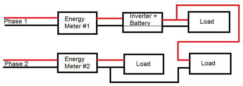

Hi,
I have two floors with two different energy meters. Both energy meters are supplied electricity from different phases of a 3-phase single neutral electric source. The basic schematic is shown in the attached picture.
On floor 1, all load is connected through the inverter.
On floor 2, some load is direct while some load through inverter. The load through inverter uses live from 1st floor and neutral from 2nd floor.
Is this okay?
Will it cause the energy meter to show leakage?
Thanks engineers :)

If the red lines are live and the black ones neutral then there is no connection from the right hand load to the meter 2. Therefore, you wouldn't expect the meter to register anything.

What I wanted to know, is it okay to use the neutral from one energy meter and live from another energy meter (through the UPS). Note that both energy meters are fed from different phases.
In case of no power failure.
load (shown on lower right) is fed from neutral from energy meter#1(EM1), and live from energy meter#2 (EM2). Is this okay? Will this cause EM2 to show leakage because current from EM1 would go through neutral of EM2?
I am worried if this would result in a short circuit, over voltage or increased energy bill (due to leakage reading, yes my energy meter also records leakage).

Put a meter between the two neutrals to check but there should be no volts if they are directly off the same three phase transformer (as in the UK and Europe). If you find more than a few mV then you may have to think again. The acid test would be to see if and how the neutral-neutral Volts vary when you switch different loads onto the two phases. (And how the Joule Meter responds, too.

there should be no problem sharing this neutral with the power meters. But if you're not sure if the neutrals are coming from the same transformer, do the test as sophiecentaur suggest.
Thanks everyone for the replies. I put a digital multi-meter (700V AC) between the two neutral, the voltage was 2-3 volts (it kept changing between 2 and 3). I guess i have to remove the load from the UPS for second floor.

Actually the guy who installed UPS did install a wire for UPS running from 1st to 2nd floor. He just took 1 white wire (for live coming from UPS) and used the neutral coming from meter. I did not know then or I would have had him install extra neutral too.
Forgot to do this. I touched the neutrals , they do not create spark. DMM is not stable, it shows between 0 A to 0.010 A. The current stays 0 but when I switch something on (like ceiling fan), then it goes up for a second, then slowly comes back to 0.

That worries me. The practice of 'borrowed neutral' is a poor one and I would question this guy's credentials. You would not be likely to find this happen in the UK, for instance. I should have expected a twin and earth cable (three conductors in a separate sleeve).
I don't see any protection in this circuit I would expect any RCCDs installed upstream of the meters to trip all the time.

I have RCCD, MCB and Isolator. Just did not show in the circuit to make it simple as it was not relevant to the question I was asking.

He was sent by the place I bought UPS from. Thanks for the mention of borrowed neutral, I am going to have all wiring checked for this.
