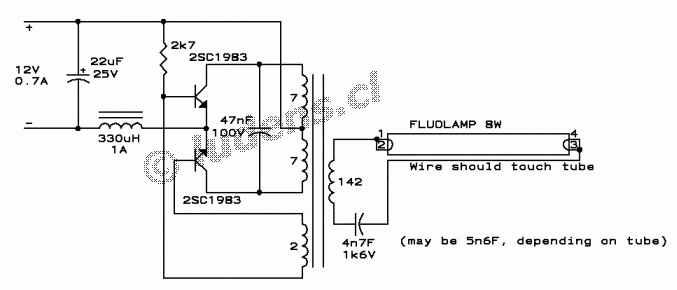

- it seems, this thing is too often forgotten (I built such things myself):
- though typically used for fluorescent lamps, it's a good way to obtain any sinusoidal voltage.
The frequency is determined by the resonant "tank" of the transformer inductance (stabilized by air gap) and the capacitor between the BJT collectors - while the tank amplitude is strictly 12V multiplied by Pi.
Very important thing here, it's the input inductor - it makes the resonant oscillation fed by current rather than voltage - but still keeps the voltage amplitude firmly determined - interesting indeed.
AlexCaledin said:
- it seems, this thing is too often forgotten:
I really doubt that would produce sine wave.
Correct.
Notice the heater filaments are not powered as the starter is not present.
It produces a ±200 V spiky output designed to strike a florescent tube.
Amplitude is input voltage dependent.
The load dependent frequency is tens of kHz.
It could be filtered but the issue is that there is no feedback to control the output. Any circuit will have some variability, especially with magnetic components in it, so the key for 0.01% is, pretty much, something with feedback.
With feedback you can make the output almost as good as the input quality. If not, then unlikely.

awwww I do admonish you) try to think again...
- it can be quartz-stabilized; and using MOSFETs (to say nothing of adding the feedback!), the voltage is made stabile enough, too.
Yes, the sinus can be wrecked easily, by means of using a real bad transformer with a heavy non-linear load.
At resonant frequency it's still decent 'low harmonics' I guess... But as a signal source for precise measurement? ...
