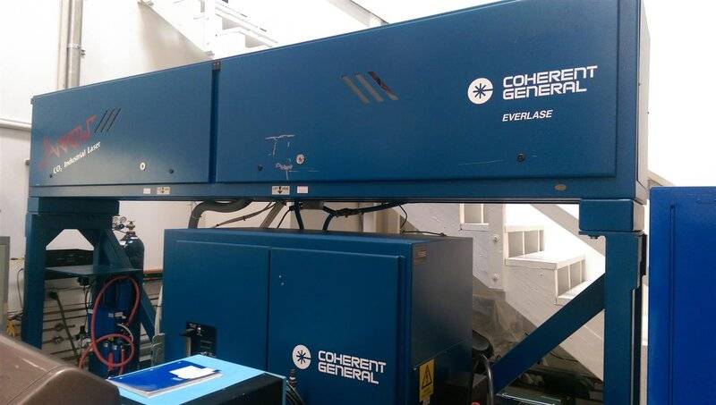

One of the scariest things I ever did was to measure the impedance of a 1KW fast flow CO2 gas laser, while it was operating, with a frequency response analyzer. This laser had a 10KV, 10KW linear DC power supply. I literally spent a day at my desk, and just looking at the laser construction, thinking about how to do this thing safely and what to do if things go wrong. Then I spent about another day building special purpose test gear to make connections, limit voltages in fault conditions, emergency kill switches, plexiglass barriers, etc. Then the test took about 1 hour, but I was scared for about 2 days in total. The opposite of "hold my beer"; fear is maybe the most important safety tool.
BTW, the impedance of ionized gasses is a really interesting thing, I wish I had those old lab notebooks. But alas, I couldn't finish that work for business reasons, the project was killed.
Also, (off topic) funny story. The product was called "EVERLASE", it was pretty awful; very unreliable. One time my boss had to go to a customer site that had had several failures. They had painted an "N" in front of the name on the side and called it the "NEVERLASE"... ouch, they were kind of right.
Blue industrial CO2 laser cabinet on stands, labelled Coherent General Everlase and 'CO2 Industrial Laser', with a smaller blue power supply unit beneath it.

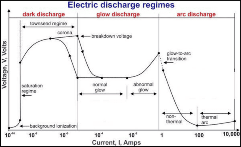

This makes no sense. That's not how arcs work. If it's current limited the voltage must drop. You need to do some more thinking about this.
edit: oops, that's not really the right link. But there's lots of stuff on the web about arc discharge I-V curves.
Log-scale graph titled Electric discharge regimes plotting voltage in volts against current in amps, with dark discharge, glow discharge and arc discharge regions, showing the Townsend, corona, normal glow, abnormal glow, glow-to-arc transition, non-thermal arc and thermal arc.
I’m not studying or trying to measure arcs. I’m trying to avoid them. Obviously, if the cap discharges, its voltage drops but not that should not force the power supply to collapse. The current limit I meant is on the power supply so it doesn’t draw a lot of current because the subject of this thread is building a somewhat safe power supply.

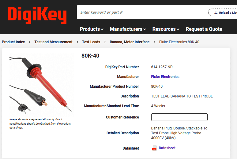

bob012345 said:
I don’t know yet how the measurement would be incorporated into the setup. If you or anyone can point me to a book, a course or some source of information on HV systems that might cover such topics I’d appreciate that.
You plug one of these into your DVM:
DigiKey product page for Fluke Electronics 80K-40 test lead: a red high-voltage banana-plug-to-test-probe lead with a black cable and a small black plug, Part Number 614-1267-ND, rated 40000V (40kV).
I don't remember the probe's input resistance, but if it is ##10M\Omega## then it will draw ##350\mu A ~at~ 3500V##
As @DaveE says, that is not how a current-limited power supply works. An arc looks like a short circuit to that power supply, which causes the output voltage to drop out. Otherwise, the supply is not "current limited"... :wink:
