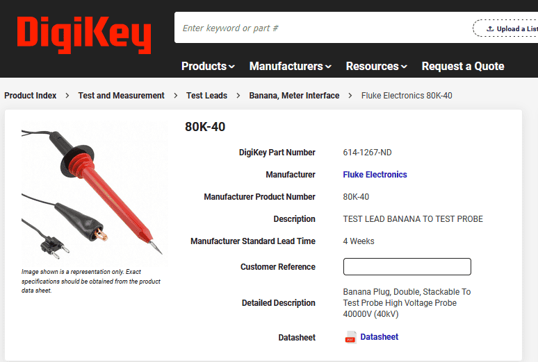

berkeman said:
You plug one of these into your DVM:
I don't remember the probe's input resistance, but if it is ##10M\Omega## then it will draw ##350\mu A ~at~ 3500V##
As @DaveE says, that is not how a current-limited power supply works. An arc looks like a short circuit to that power supply, which causes the output voltage to drop out. Otherwise, the supply is not "current limited"... :wink:
Used to use one of those working on color TVs. Some chassis's were made so it was difficult to slip that probe under the silicone cap that seals against the picture tube. Larger color TVs had around 30 KV on the second anode under that silicone cap and slipping the probe in under would sometimes cause an arc off to the chassis.
  • #33
Yes, those are very clumsy to use in practice on smaller equipment. I sometimes would unscrew the tip and connect a HV wire to connect to the circuit, but of course that was a semi-permanent set up that had to be done in advance with some care. A lot of that stuff is designed for industrial installations where there's more space.
A small hand-held HV probe is kind of an oxymoron.
