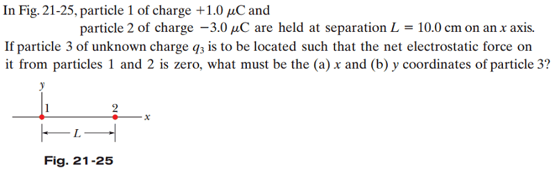

How to solve for unknown charge position
5 replies · 2K views · last reply
PhizKid
477
Diagram of two charged particles on a horizontal x axis, particle 1 at the origin and particle 2 a distance L to its right, with a y axis drawn upward through particle 1.
Coulomb's Law
Coulomb's law force equation: F = k_e q1 q2 r-hat21 / r21 squared, written as typeset vector notation.

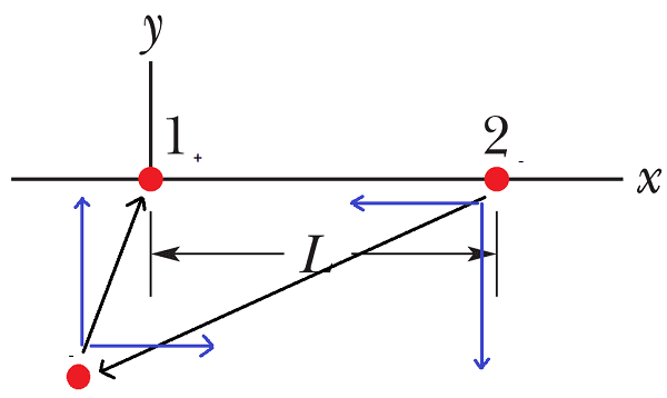

Here are 2 different possibilities I drew that I think will have the x component vectors and y component vectors cancel out, but I think there may be some other positions as well.
Diagram of a horizontal x axis and vertical y axis with a positive charge labeled 1 at the origin and a negative charge labeled 2 to the right, separated by distance L. A third charge q3 sits below-left, with force arrows drawn from it toward charges 1 and 2 and blue component arrows along the axes.
Diagram of a charge at point 1 on the x-axis labeled 1+ and a charge at point 2 labeled 2- separated by distance L, with a third charge below-left and blue force arrows and black position vectors drawn from it.
##\textbf{F}_x = k_e [\frac{(1.0 \textrm{ uC} \cdot q3) \cdot cos(\theta_1) \cdot \hat{r}_{13}}{{r_1}^2} + \frac{(-3.0 \textrm{ uC} \cdot q3) \cdot cos(\theta_2) \cdot \hat{r}_{23}}{{r_2}^2}]##
##\textbf{F}_y = k_e [\frac{(1.0 \textrm{ uC} \cdot q3) \cdot sin(\theta_1) \cdot \hat{r}_{13}}{{r_1}^2} + \frac{(-3.0 \textrm{ uC} \cdot q3) \cdot sin(\theta_2) \cdot \hat{r}_{23}}{{r_2}^2}]##
But there are so many unknowns and I only have one equation (Coulomb's) so I'm not sure what to do from here.

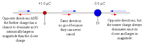

I suggest that you make another drawing and use it to further narrow down the region of interest. Then you can write expressions for the force magnitudes without any signs involved. For example:
Number line with a +1.0 μC charge at 0 (red dot) and a -3.0 μC charge at 10 (larger blue dot), with arrows showing force directions in three regions: opposite directions with the further charge dominant, same direction, and opposite directions with the nearer charge dominant.
The diagram shows there's only one region that the third charge can be located so that zero net force can occur.
Since all the given values have similar units (μC, cm), you can drop those too when you write the equality.
