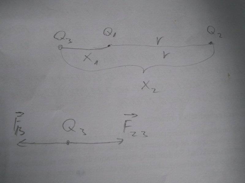

Two point charges ##Q_1 = 9 \mu##C and ##Q_2 = -16 \mu##C are fixed in space on a distance r=7cm. At what distane ##x_1## from the first charge, and ##x_2## from the second charge, should we place the third charge ##Q_3## so that net force on ##Q_3## is zero? make a sketch with force diagram for third charge. Is ##Q_3## positive or negative? What distance from ##Q_1'## and ##Q_2## should we put ##Q_3'## at, if charge ##Q_3'## is ##0.5Q_3##

Charge ##Q_3## must be positive in order to be stationary in presence of charges ##Q_1## and ##Q_3##. It's visible from the sketch in the attachment.
Since the net charge on ##Q_3## is zero it follows that ##F_{13}=F_{23}##.
##F_{13}=k \cdot \frac{Q_1 Q_3}{x_{1}^2}##
##F_{23}=k \cdot \frac{Q_2 Q_3}{x_{2}^2}##
##x_2=r+x_1## is visible from the picture attached.

If I try to solve this equation with r=7cm I get a result with real and complex part. If I insert r=0.07m I get something similar. How do I fix this?

The charge on Q3 can be either negative or positive. Also, when you drew your FBD and setup your Fnet statement you already considered direction, so you don't have to include the signs on the charges in your calcs

First, you mean there is no net force on Q3. Secondly, it helps to be consistent about which way is positive for forces. Think again about the claim that the forces are equal.
##F_{13}+F_{23}=0## or
##F_{13}=-F_{23}##

This makes sense. Does ##x_2## mean I can also put the charge ##Q_3## between ##Q_1## and ##Q_2##?

Think about your last statement logically by first putting a positive charge between the two other charges and then a negative charge. What will be the net force acting on the new charge?

Yes that's what it means. In general negative value means towards the right of Q1, positive value towards the left of Q1. And this follows from the way you setup the equations and the diagram in the picture.

that is correct for x1 but I do not understand how you get -3 for x2. You wrote originally, and correctly, x2=r+x2.
It would make no sense to put Q3 between a positive and negative charge. The fields from the two fixed charges would reinforce each other there, not cancel.

Symbol ambiguity error (lol). When he says ##x_2## he means the second root of the equation.
But you are right in between the forces can't cancel out. So the second root of the equation does not correspond to solution in the problem. That's because ##F_{13}## changes direction if ##x_1## becomes negative but the way the equations are setup this can't be seen. The only way to account for the direction change is to write ##F_{13}=k\frac{q_1q_3}{\mid{x_1}^3\mid}x_1## and similar for ##F_{23}##.

The two solutions only indicate the two values for ##\ x_1\ ## for which the magnitudes of the forces are equal. Use @rpthomps post to see if that's enough.

I see I've made some typing errors and my notation for distance of ##Q_3## from charge ##Q_1## isn't appropriate. Also, when ##x_1=-3cm## charge ##Q_3## must be negative because it is closer to the positive charge. If it was positive, it'd be repelled. Thank you all for your help and pointing that out. I hope I didn't make a mistake in this post :)
