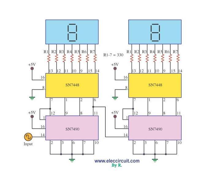

I can perform counting 0-99 but how do you stop it in 59 then 00 then back to 01?
heres a sample
heres a sample
You'd have to build yourself a different state machine that could do that. Or, being a CS type, you'd write a dozen lines of code for a microcontroller, providing BCD output to your 7-segment display drivers.
On the assumption that you're looking for some kind of time-keeping device, you can also use an RTC (real time clock). Some even come integrated with crystals (or if not, you can find yourself a 32.768 kHz--2^15 Hz crystal). Heck, I've seen one which was basically an alarm clock on a chip (think it came from Maxim).
