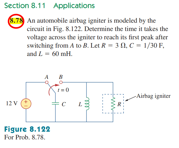

paulmdrdo
89
Find the expression for ##v(t)##
SEE ATTACHED PHOTO

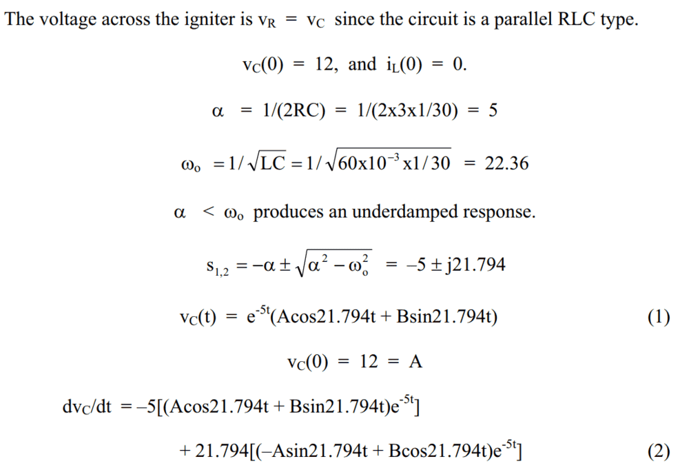

I was trying to follow the solution for this problem and got stuck in the last portion of the solution. I encircled the part that I did not understand. I can't figure out how the solver was able to come up with tangent terms. Please enlighten me. TIA
242126
242127
242128
The author equated eqn (2) to 0
then extracted (and divided both sides by) the common factor 5(cos 21.749t)
