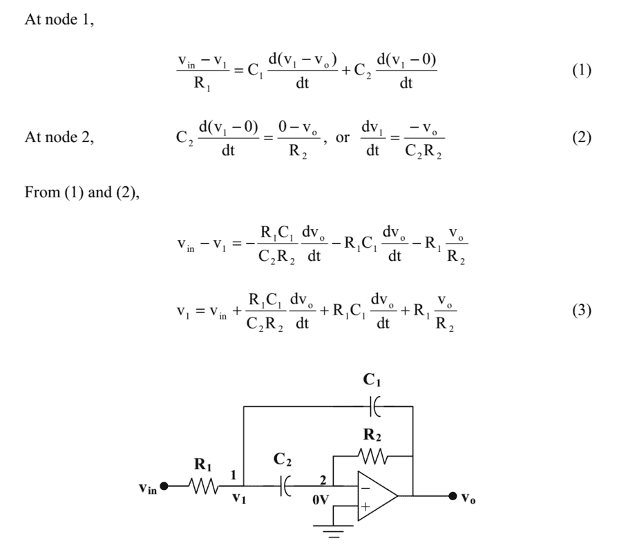

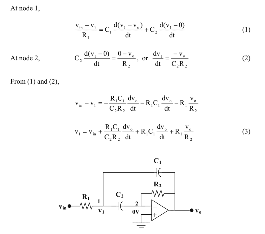

Find the expression for vo(t)
See the attached photo

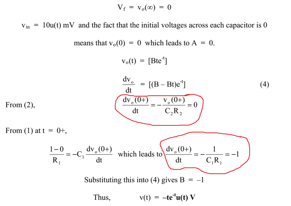

I was trying to understand the way this problem was solved and I got confused with the latter part of the solution. I encircled the part that confused me. They seem to contradict each other. If dv(0+)/dt = 0 why is it dv(0+)/dt = -1 in the other one? Please explain. TIA!

  • Handwritten-style derivation of node equations for an op-amp circuit: equation (1) at node 1, equation (2) at node 2 giving dv1/dt = -vo/(C2R2), and equation (3) solving for v1. Below is the circuit schematic with R1, C2 and C1, R2 feedback, node labels 1 and 2, and output vo.

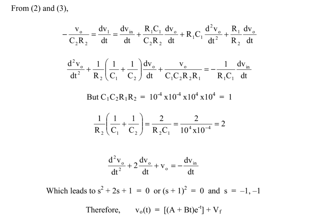

  • Handwritten derivation of a second-order op-amp circuit equation, with a repeated-root characteristic equation s^2 + 2s + 1 = 0 giving s = -1, -1 and the solution v_o(t) = [(A + Bt)e^(-t)] + V_f.

  • Handwritten-style typeset derivation of a second-order circuit response: Vf = vo(∞) = 0, vin = 10u(t) mV, v_o(t) = Bte^-t, dv_o/dt = (B − Bt)e^-t (4), with two red-circled expressions dv_o(0+)/dt = 0 and dv_o(0+)/dt = −1/(C1R1) = −1, concluding B = −1 and v(t) = −te^-t u(t) V.
http://i67.tinypic.com/t6s31y.jpg
The first thing you have encircled in red says that it's "From (2)". If you go back to (2) you'll see that where the red circled part says first thing: dVo/dt (0+), it should actually be dV1/dt (0+)
