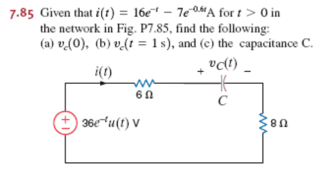

Circuit schematic of a series RC network with a 36e^-t u(t) V voltage source, a 6 ohm resistor, a capacitor C with voltage v_C(t) across it, and an 8 ohm resistor, with current i(t) flowing through the loop.
[/B]

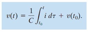

2. Homework Equations
Equation for capacitor voltage: v(t) = (1/C) times the integral from t0 to t of i dτ, plus v(t0).

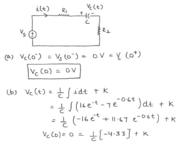

Handwritten series circuit with voltage source Vs, resistor R1, capacitor C with voltage Vc(t) across it, and resistor R2, with current i(t) marked, followed by handwritten steps finding Vc(0) and integrating i(t).
In got stuck. I'm not sure as to what Time constant should I use to solve for the capacitance value. In the original expression for the current, both terms are exponential function. I do not know whether to use the time constant associated with the first term or the second term.

Delta2 said:
The voltage of the source is given by ##V_s(t)=36e^{-t}u(t)## ?? What function is ##u(t)##?
That's a unit step function.
Well ok, I am not 100% sure but I believe the second exponential contains info about the capacitance. More specifically I think that ##\frac{1}{(R_1+R_2)C}=0.6##
Thank you. That's what I thought too. But It would be nice if someone would explain as to why that is the case.
By setting up and solving the differential equation for this circuit and using that ##V_s(t)=36e^{-t}## I found that the current is $$I(t)=ae^{-t}+be^{-\frac{t}{(R_1+R_2)C}}(1)$$ for some constants a and b and by comparing this with the equation you give for current, I decided my conclusion.
If there was zero initial charge on the capacitor, then the current magnitude at t=0 would be 36 ÷ 14 amps. But we are told the current is a spike or pulse of magnitude 9 A peak at t=0. So we conclude there must be some initial charge on the capacitor in order to give a total loop voltage at t=0 of 9 ×14 volts.
If you set up and solve the 1st order D.E. this should be confirmed.
