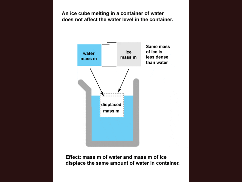

At the risk of violating the rule of 'Ask, don't tell' I attach this diagram which addressed the same question posted here a long time ago.
Diagram titled 'An ice cube melting in a container of water does not affect the water level in the container', showing equal masses m of water and ice, with ice less dense, displacing the same volume of water in a container.
  • Diagram titled 'An ice cube melting in a container of water does not affect the water level in the container', showing equal masses m of water and ice, with ice less dense, displacing the same volume of water in a container.
Which, by the way, is why floating Arctic ice won't change the sea level when it melts.
Good old Archimedes got it when he said the weight of water displaced is equal to the upthrust. When an object floats, what does that tell you?
Units units units. If you add one kg of water or one kg of ice to a pool of water, the level rise is the same. But one kg of ice needs more gallons (volume) than a kg of water. That is why ice floats instead of sinking.

NICE! that's what I thought! only Ice that is grounded will effect the sea level. thanks

Well, not quite. Much of the floating sea ice is fresh water ice. Sea water is denser than fresh water. Ergo, the volume of fresh water produced by the melting ice will be a slight bit larger than the volume of sea water that it displaced. It's a small effect, but an effect none the less.

That's true if it is fresh water ice floating in fresh water. But fresh water ice floating in salt water is a different case because salt water is denser than fresh water. ( one way to look at it is that the fresh water iceberg floats a bit higher in salt water than it does in fresh water, so a little less than 90% of it will be underwater, but it still produces the same volume of water when it melts.
