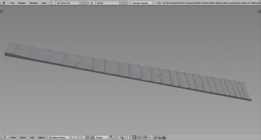

I am catching the last minutes of a weekend, I've got much work next week. Here is what I have so far. First picture shows ellipse, if you look closely. Upper spikes of teeth count. Second picture is 3d view. True temperament frets, elliptical fretboard, fanned scalloped neck.
I hope you have the proper tools for this. If you are using a scalloped neck, the reason for scalloping is that you do not push the string to fretboard. If you try to set it up by pushing the string all the way to the fretboard, you will never get it in tune across the fretboard. With scalloping, the idea is to just press lightly enough for the string to make contact with the fret. You have to have a very light touch to play that in tune.
As far a temperment goes, if you aren't using equal temperment, playing in any but the key it's tempered for is a problem. That's the issue Bach settled with equal tempered tuning. Every key is a few cents out of tune, but you can play in any key. The fanned frets just give you different scale lengths for different strings, presumably to make the tension across the strings uniform. (This problem and others were solved by Ned Steinberger with calibrated double ball strings. BTW, Ned's father was a Nobel Prize winner in physics for discovering the muon neutrino.)
