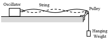

typical standing-wave setup
The above figure shows a typical standing-wave setup. An oscillator at one end of a string vibrates vertically to produce waves along the string, while the weight hanging at the other end holds the string taut. A pulley confines the waves to the horizontal section of the string while still allowing the force exerted by the weight to hold the string taught.
The following quantities come into play when analyzing a standing-wave setup for a string.

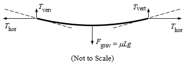

The figure below shows the forces acting on the string when it is at rest. Included are the tension forces, resolved into horizontal and vertical components, acting on each end of the string, as well as the downward gravitational force.
The weight of the string and the two vertical forces ##T_\rm{vert}## balance each other, so ##T_{\rm{vert}} = (1/2)\mu L g~.##
Since the tension force acts along the string, the ratio of the vertical and horizontal tension components must equal the slope of the string: ##T_\rm{vert}/T_\rm{hor} = \frac{dy}{dx}|_{x=L/2} = aL = 4\delta~.## ##T_\rm{hor}## is approximately equal to the tension T, since the string is nearly horizontal (##\delta## and ##T_\rm{vert}/T_\rm{hor}## are much less than 1.) We can then write
$$T_\rm{vert} = 4 \delta T = 0.5 \mu L g $$
$$T_\rm{min}/\mu = L g / (8 \delta)$$
$$v = \sqrt{T_\rm{min}/\mu} = \sqrt{\frac{Lg}{8\delta}}$$

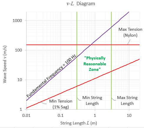

The v-L Diagram
The figure below shows the 5 constraints plotted on a diagram of ##v## vs. ##L## for a nylon string with a minimum sag of 1%. Values of ##v## and ##L## that meet all 5 constraints lie within the five-sided “Physically Reasonable Zone” in the diagram.

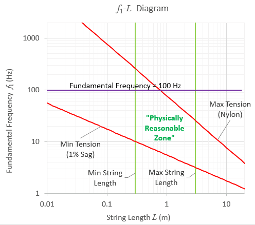

The f1-L Diagram
Knowing the values of physically reasonable wave speeds can be useful for writing physics questions. On the other hand, to set up an actual standing wave demo it may be more useful to think in terms of the fundamental frequency ##f_1## rather than the wave speed.
The constraint equations can be modified by substituting ##(2L)f_1## for ##v##. (##2L## is the wavelength of the fundamental mode.) Solving the resulting equations for ##f_1## then gives new constraint equations, which are plotted in the diagram shown below. Again, this diagram is for a nylon string with a maximum sag of 1%.
