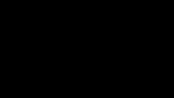

This may not be relevant, but I was able to hear different "pitches" to the individual clicks of a sawtooth, like each click had a different/higher characteristic.
*link to video.( you may have to open it with Google drive itself ).

I couldn't get to the linked media, so I'm not sure what is being played. I just hear 11 'thumps'.
If those are ~ 1 Hz sawtooth waves, then I'd expect to hear a noise burst ("thump") at one second intervals, as the steep slope will create a lot of high frequency energy. The gentle ramp would be too low for our ears to pickup.
Can you show the waveform, and what you expect (or are surprised) to hear?
