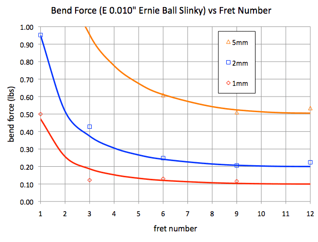

Is there a way to calculate how frequency will change if I stretch a string by certain amount (0.14 mm in my case)? I found out I can measure its frequency once stretched, but no results as of how to estimate new frequency ahead of the time. I know a speed of string can be calculated from its weight, length and tension, but that doesn't seem to get me anywhere:
- I don't know how to calculate the tension from delta length.
- I don't know how speed of string and its frequency are related.
Any help would be appreciated.
Thanks.

If it's to represent a real guitar then the actual stretch can be particularly relevant for a badly set up instrument. Every lad has had to deal with a rubbish old starter instrument with a horrid bowed fretboard. Suddenly you get a better guitar with a light action that's been set up right and you can start to play in tune.

I'm not sure this is true with a guitar since the vibrating part of the string has a constrained length. So when you tune up the tension increases and the linear density decreases but the scale length stays the same.
So I think you do need to know a little bit more...
In that event, the calculation is easier because all that has changed would be the mass per unit length. As you say, the length between nut and fret would change very little unless you 'bend' the note sideways.
Edit: When you bend the note, both ends of the string get stretched so you would need to do some trigonometry to take account of the unequal lengths involved. (Too hard guv'.)

I don't believe that's true. The action typically increases as you move down the fret board so there is a larger deflection required to fret the string at the twelfth fret versus the first fret. But the bending force at the lower frets is disproportionately higher due to the geometry and this more than makes up for the difference in the action. You don't have to be a good guitar player to notice that it's harder to bend or even just fret string at the first fret versus the twelfth.
