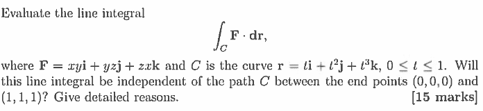

Here is my problem :
so far I've solved the line integral but I don't know what is the condition that must be met in order to be independent of the path given.
I found the line integral to be: 27/28
Try an other path between points (0,0,0) and (1,1,1) . What about a straight line, connecting them?

If the Curl of the vector field = 0 it is conservative and hence path independent.
How would you find the curl of the vector field?

The integral of a vector function, [itex]\vec{F}[/itex], is independent of the path if and only if it is "a derivative". That is, if there exist a real-valued a function, f, such that [itex]\nabla\cdot f= \vec{F}[/itex]. That will be true for this vector function if [itex]f_x= xy[/itex], [itex]f_y= yz[/itex], and [itex]f_z= xz[/itex].
We can check if that is true by looking at the mixed second derivatives: [itex]f_{xy}= x[/itex] and [itex]f_{yx}= z[/itex]. Those are NOT the same so this function is NOT independent of the path.
