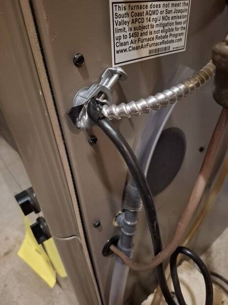

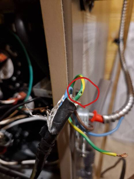

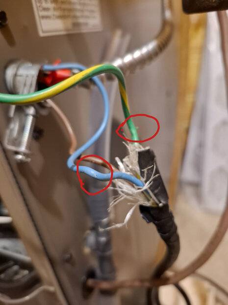

OK furnace finally failed. I didn't even get to start the dead testing yet.
Right now, when I switch it on and call for heat, I can hear it starting up and it reaches a steady hum but the fan won't start. I took out the fan motor capacitor which is a 5uF +-5% and tested it. The reading really bounced around a lot then settled on 4.62uF (just out of range) then dropped to 0 after that.
I noticed that there is a little rubber cap that is supposed to cover the contacts and it was not on, just dangling down the wires. I put the rubber cap back on and no stray current on the power line. So I am thinking that what @Tom.G . said may be the solution.

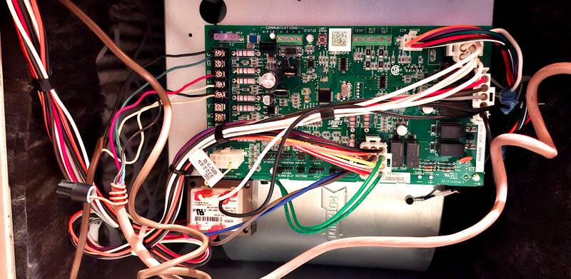

OK I am back and this time I have some pictures. As we have now shifted from cold weather to hot weather I put on the AC and noticed same problem as with the furnace line. The dedicated AC line has net current on it.
Here's what is going on inside the Furnace:
Just learning the colors for HVAC here but condenser (AC) power enters the furnace from the AC and has black and white wire like what you'd see with AltCurrent wiring (except no green ground)
The main control board inside the furnace looks like this:
From Top to Bottom:
C Terminal:
The black wire is coming from the condenser
and the blue wire is the fan wire from the thermostat being used as a common
R Terminal:
From thermostat of course
Y/Y2:
Black coming from thermostat and white coming from condenser
**Is that the problem here??*** Should it be white to common and black to Y/Y2??
(see below)
Dedicated AC (condenser) line has net current (just like the furnace line):
Switch the Condenser black from common to Y/Y2 and the common from the condenser to C terminal?

Ok, you are introducing a lot of things here. Simplify simplify simplify! Start by turning off the main breaker and ALL other breakers in your house. Measure the cable feeding your furnace. You may still have current showing. It's not uncommon for ground paths to carry current through the water system. It's not out of the question for it to show up someplace like this. If you do have current showing here there's likely little you can do about other than hunt around to verify the path.
Assuming the current has fallen to zero, start turning on breakers. Start with the main only. Watch your meter and turn on one breaker at a time while keeping an eye on your meter. Leave the furnace and A/C unit until last. Let us know the results.

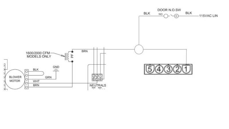

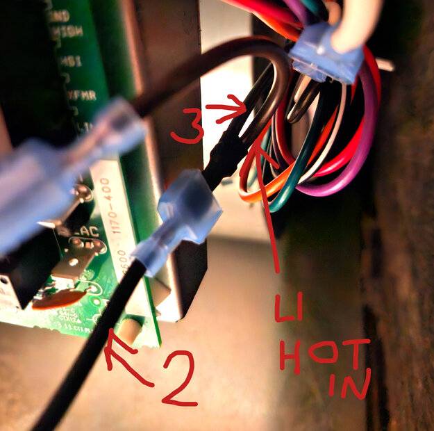

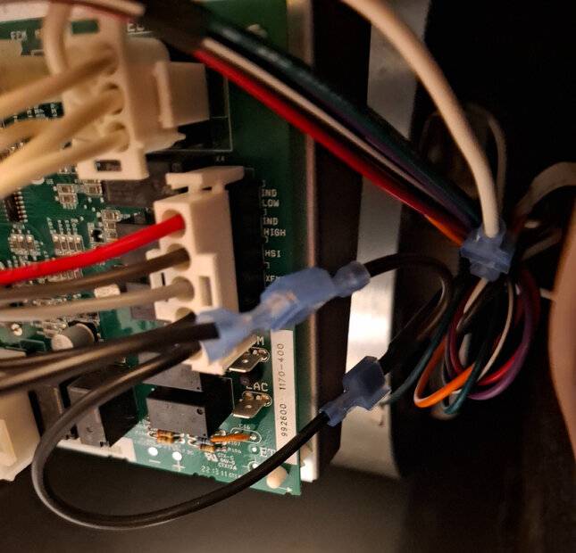

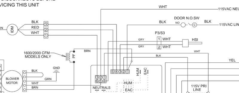

OK so I have been working at it and traced it back to this:
Here is my question:
What should this look like practically:
  • Hot is coming into Molex terminal 1
  • Another wire leaving Molex Terminal 1 going to Blower Motor
What I have inside my furnace is this:
  • BLK Hot bypasses terminal 1 of Molex Plug on board
  • BLK Hot is put through a connector (heat shrink butt connector..?) and turns into a BROWN wire
  • BROWN wire is then put through another connector (spade connector..?) and comes out as 2 brown wires
  • One BROWN is looped back and attached to terminal 1 on the board
  • The other goes on to the Blower Motor
The pic below, hard to see, circled is one of the brown wires after the split being inserted into terminal 1 of the plug on the board.
Right or wrong?

So what you are saying is the diagram doesn't match the physical wiring? You need to draw something. I'm not going to try to decode your description. Make a schematic. It's unlikely that it is actually wired as the diagram shows. If the breaker is turned on, then the blower would run all the time.
Just exactly how did you arrive at 'traced it back to this'? Did you isolate the two units as I suggested? The idea is to shrink the number things involved until there is very little left.
  • #46
OK I will draw a diagram.
I traced the current imbalance and did continuity tests on the components along the way--everything was OK-and as I kept going I came upon this wiring error.

You still don't seem to understand why you need to isolate. Of course you traced the imbalance to the place you circled. It's basically the first stop. Unless the current is leaking in the door switch, the amount of current around the place you circled will be them same as the hot wire on the way from the breaker panel.
It's likely not what you refer to as a wiring error. Not sure why they do this but there is likely a good reason.

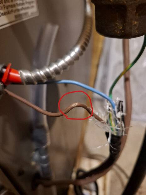

I tested everything components and even the wires themselves. I found one spot where a wire was pinched and had copper exposed and it was touching the cabinet and leaking some current onto it but that wasn't the main problem although it took some of the stray current off of the main line.
Sorry again I am just incredibly exhausted from work.

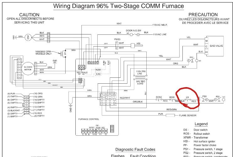

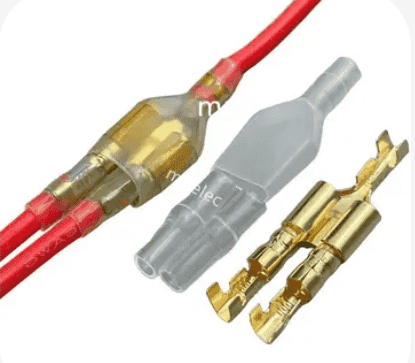

Can someone be so very kind as to tell me how you'd wire that little bit in the circle at contact 1 on the Molex so that I can start thinking about it during bout of semi-consciousness?
Also this is a noob question because I don't wire things for a living... what the heck is this type of connector called because this is what I have in the place where I believe there may be that wiring error.
  • #52
OK here is the best I could do on my Chromebook with the mental resources that I currently have access to:
Manufacturer's Diagram (Close Up of Relevant Section)
The Wiring in my Furnace
(The Best I Could Do With What I Got)
Seeking your advice. You guys do this for a living and I don't but I can learn if you are willing to teach.

How we would wire it is not relevant. You need to provide a diagram of how it IS wired. If you have in fact done so then I question the accuracy. The way it is shown would have the blower motor running all the time. This does not seem right.
UrbanFarmEngineer said:
How is it possible that the same amount of current is going to flow to contact 1 in the first diagram as in the second?
It doesn't matter what goes into contact one. It matters that whatever total current goes into the furnace assembly on the hot wire also comes back on the white wire. Wherever it branches off inside the furnace is not relevant.

  • #60
> I'd say your schematic matches your physical wiring.
Do you say that the diagram I posted is equivalent to the manufacturer' wiring?
Help me understand. I can't see that. Would the path of current flow be the same in both?
