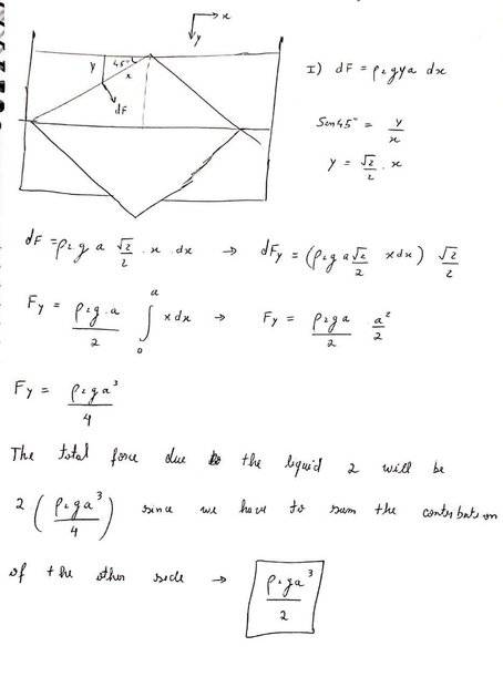

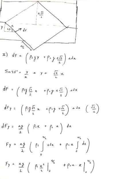

I just did the another solution. I will attach here. Got the same as you again.
In the first photo I calculated the force due the liquid 2
In the second one the force due the liquid 1 (taking into account the pressure that liquid 2 keeps exerting)

  • Handwritten derivation of hydrostatic force on an inclined face of a tank: sketch with dF = rho g y a dx, sin45 = y/x, then F_y = rho g a^3/4 and total force 2(rho g a^3/4) = rho g a^3/2 boxed.
  • Handwritten derivation of the vertical force on a submerged square block, with a sketch of the block at a 45 degree tilt in a container and the expression dF = (rho1 g y + rho2 g y a√2/2) a dx, followed by integrals giving Fy = (ag/2)(rho1 x²/2 + rho2 a x) evaluated from 0 to a/√2.
