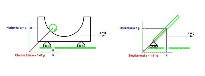

Here is an explanation in the accelerated frame. First refer to the picture on the left below. The apparent acceleration of gravity is the vector sum of the horizontal ##(\mathbf{-a})## and the vertical acceleration of gravity ##\mathbf{g}##. The fluid surface (blue line) will be perpendicular to the apparent acceleration of gravity. In the non-inertial frame the hydrostatic pressure will be ##p=\rho~g_{\text{app}}~d## where ##d## is the perpendicular distance to the surface from the point of interest. That was my approach in post #3 where I suggested that one needs to find ##d## and ##g_{\text{app}}##. However, that is unnecessary extra work.
Refer to the picture on the right where the perpendicular distance to the surface is shown as ##d##. Note (what I missed at first until @Orodruin pointed it out) that from the picture on the left $$g = g_{\text{app}} \cos \theta.$$
Then the hydrostatic pressure at perpendicular distance ##d## from the surface is $$p=\rho~g_{\text{app}}~d=\rho~\frac{g}{\cos\theta}~d=\rho~g~h.$$On edit: The same argument stated differently. Planes parallel to the surface are planes of constant hydrostatic pressure. So when you go from point A to point B, the pressure change will be the same as when go from A directly to C because there is no change in pressure when you go along the surface from B to C.
On second edit: If the picture on the right were rotated counterclockwise by ##\theta##, so that the apparent gravity is aligned from the top of the screen to the bottom, the proposition that the pressure difference between A and B is the same as between A and C would be perfectly acceptable to "inside the box" thinkers.

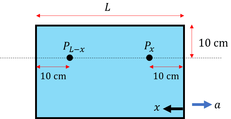

$$P_{L-x} \neq P_x$$
If you've ever done the experiment when you are in the car with a helium balloon. You accelerate, and the balloon floats forward( which without considering the air in the car as a medium that feels the inertial forces should be unexpected). This is due to the pressure gradient created in the air of the car from the acceleration, and the fact that the balloon is buoyant.

If there is a lid, the pressures of the water at points along the lid are not all equal to atmospheric pressure.
We would do well to specify some details about the lid. I assume that:
1. The lid is rigidly attached to the tank. It stays horizontal when the tank is accelerated. It does not pivot in the middle, for instance to match the surface of the water. Nor does it slide up and down. Nor does it bend up and down significantly.
2. There is a vent on the right edge. So that the pressure of the water at the upper right corner of the rightward-accelerating tank is assured to match atmospheric pressure.
[We put the vent at the upper right corner so that we do not need to explain about negative gauge pressure, the absence of vacuum boiling and why water would not flow out of a small vent hole at the upper left. Or at the tank bottom or anywhere else. We use only one small vent hole because we want to make a static equilibrium possible. We use at least one vent hole because we want to avoid a scenario that is statically indeterminate].
In this circumstance, the pressure near the left side of the tank has a contribution from both the horizontal pressure gradient (from acceleration) and from the vertical pressure gradient (from gravity), no matter how you trace pressure differences along a path back to the reference point at the vent.

If I analyze from force perspective, is it correct to say the horizontal pressure comes from net contact force between the water and the left and right side of the tank where contact force from left side > contact force from the right side?
Thanks
I think that I agree with what you are trying to say. But I have quibbles about the way that you have said it.
I think that you are saying that the horizontal pressure gradient results from the difference between the contact force (per unit area) on the left side and the contact force (per unit area) on the right side.
Yes. This is correct.
The force difference (per unit area) results in a particular acceleration rate. Obviously, that acceleration rate will vary depending on the fluid density and on the distance between the right and left walls.
Because we assume that the fluid in the tank is in equilibrium, the acceleration rate must be uniform throughout any horizontal column of water that is being accelerated rightward. It follows that the pressure gradient (the pressure change rate per unit horizontal distance) is also constant throughout the column. Each tiny cube of water must have the same pressure difference from left to right as any other tiny cube of same size. At least as long as the fluid is incompressible and equilibrium is to be maintained.
The actual pressure (not pressure gradient) at the center of the (hypothetical, rigid, closed-on-all-six-sides) tank might be estimated as the average pressure on the six sides, though I am sure that there are pathological shapes where that estimate would be wrong.
