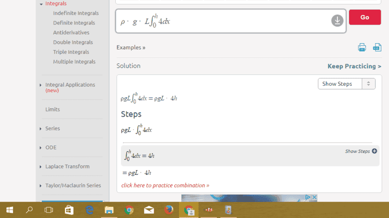

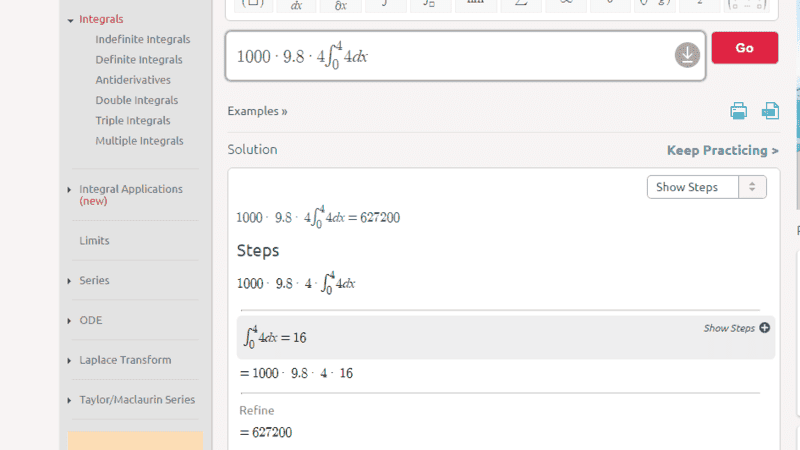

did I enter everything correct?
You are supposed to be integrating from 0 to h, not from 0 to 4. You are supposed to be integrating x, not 4. And what @haruspex is trying to get you do to is to express the result in symbolic form. You should wind up with an expression involving ##\rho##, ##g##, ##h## and ##L##.
