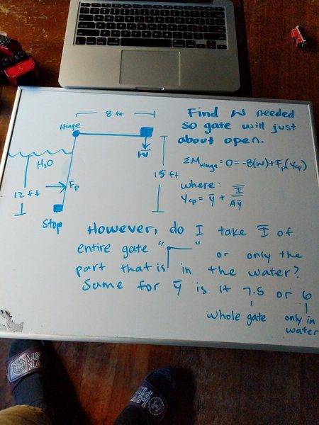

I drew a picture[/B]
I drew a picture
I drew a picture
I drew a picture
I drew a picture
What is I? Is it the MOI? I'm having a hard time understanding your post.
Can you please describe the problem a bit more. I get that there is a rigid structure that is holding off the water pressure via the weight, but I'm not understanding your equations on your whiteboard so far. Can you type them into the forum window and describe them please? Thanks.
