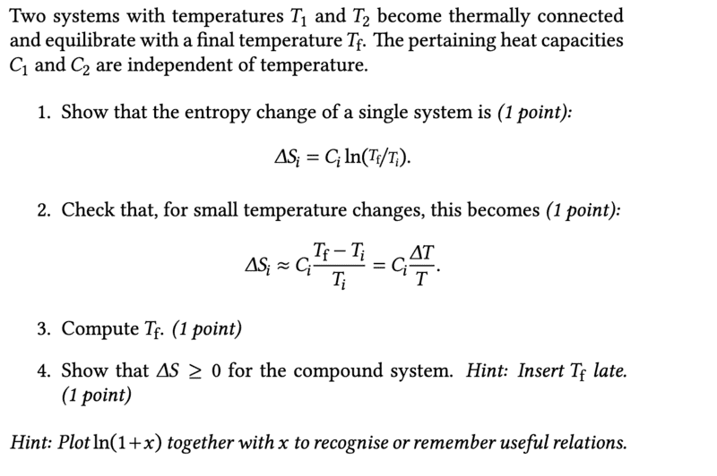

Hi,
Unfortunately, I have problems with the task 4
In task 3 I got the following
$$ T_f=T_ie^{\Delta S_i - c_i} $$
Then I proceeded as follows
$$ \Delta S = \Delta S_1 + \Delta S_1 $$
$$ \Delta S =c_1ln(\frac{T_ie^{\Delta S_i - c_i}}{T_1})+c_2ln(\frac{T_f}{T_2})$$
$$ \Delta S =c_1ln(\frac{T_1e^{\Delta S_1 - c_1}}{T_1})+c_2ln(\frac{T_2e^{\Delta S_2 - c_2}}{T_2})$$
$$ \Delta S = c_1ln(e^{\Delta S_1 - c_1}) + c_2*ln(e^{\Delta S_2 -c_2}) $$
$$ \Delta S = c_1*(\Delta S_1 - c_1) + c_2*(\Delta S_2 - c_2) $$
Unfortunately, I can not get any further now
Did I do anything wrong, or am I missing something that I can show that this expression is greater than or equal to 0?

Stop manipulating expressions and start thinking, I would say.
Your result for task 3 is both mathematically wrong (It doesn't follow from the expression in task 1) and it doesn't help you as long as you don't know ΔS for either of the systems, and for that you need Tf.
You are going round in circles!
So, you need to determine Tf first, without using ΔS.

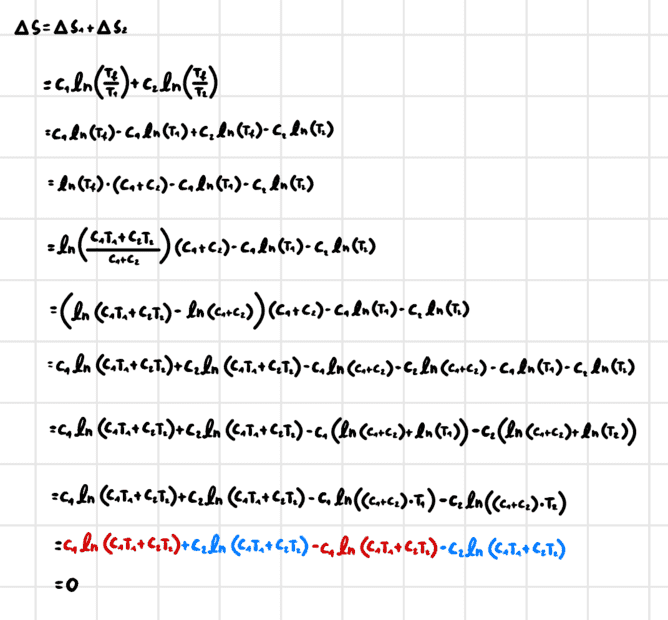

Thank you Philip and kuruman for your help 👍 I was now able to show that the entropy change is greater than or equal to zero :smile:
Here is my solution

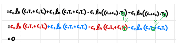

Lambda96 said:
That would mean that the process is reversible, but if T1 and T2 are not the same it should be irreversible and ΔS should be larger than 0.
TSny said:
Meant for the OP:
The expression before the mistake pointed out above by TSny is symmetric in T1, C1 and T2, C2 so you can simply decide that T1 > T2. I believe that will lead to ΔS > 0.
Thanks TSny and Philip for your help 👍 , I have corrected the error before submission, thanks again for pointing it out 👍
