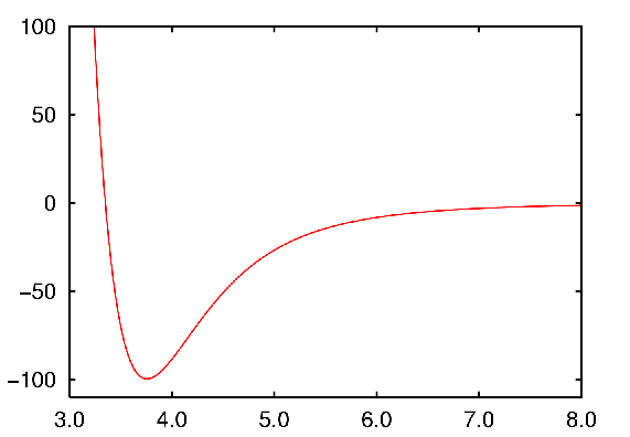

I cannot find the equation for this graph.

I need it for a program I am writing. I found it all over the net but never with an equation. After two days I'm giving up and hoping someone recognizes it. It doesn't have to be exact I can fix it up but the profile needs to be the same.
Here it is:

That shape looks familiar, but not sure from what exactly. Physics or physical chemistry?
If you just want a function that fits the graph but you don't really know the mechanism making the shape, try polynomial function fit. Maybe third or fourth degree polynomial can give a good fit. Your graph shows fairly easily readable points. You'll only need the simplest of Linear Algebra skills to determine the function.
Got it--Morse potential.
http://en.wikipedia.org/wiki/Morse_potential
f(x)=e-2x+2-2e-x+1
Used to model nucleon-nucleon interactions.
