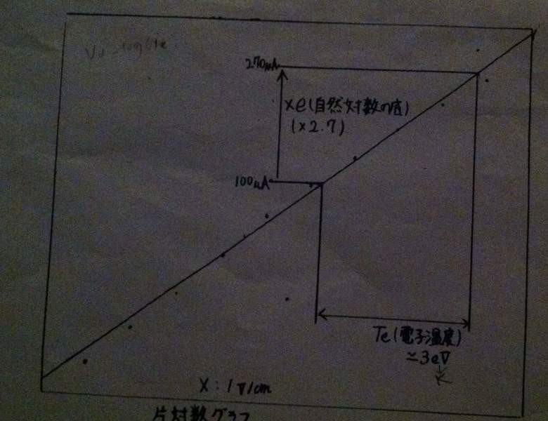

I don't understand how to get the temperature from this graph?
MissP.25_5
329
This is an experiment on plasma control. A graph of current against voltage is drawn on a semi log paper. From this graph, we can get the electron temperature (measured in eV). The method is shown in this picture, but I don't understand it at all. Can someone please explain it to me?
  • Handwritten semi-log graph on paper with a straight diagonal line, a vertical arrow labelled xe (natural log base, x2.7) from 100 uA to 210 uA, and a horizontal bracket labelled Te (electron temperature) = 3 eV; the x-axis is labelled 1 V/cm.
Not my field but looks like they picked two points separated by a factor of 270uA/100uA = 2.7 = e on the vertical scale for convenience... ln(e)=1
Something like that anyway.
