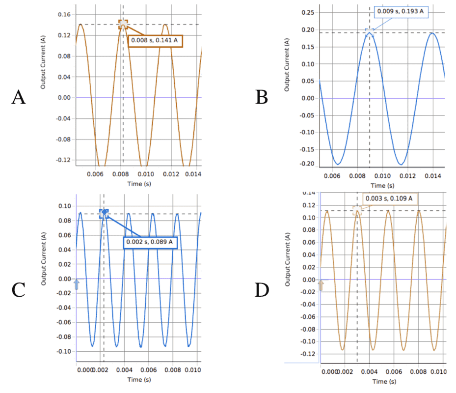

Coils (given a oscillating graphs where these measurements are taken at an amplitude peak):
- A : (0.008s, 0.141A)
- B : (0.009s, 0.193A)
- C : (0.002s, 0.089A)
- D : (0.003s, 0.109A)

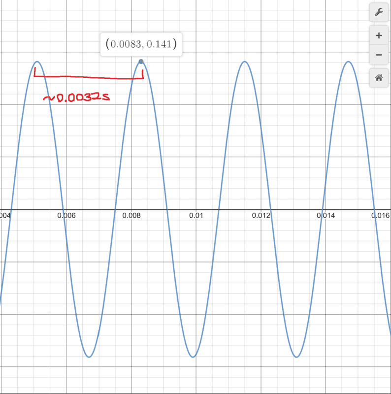

1. Matching Current v. Time Graphs to Oscilloscope Graphs
Example of one pair of graphs (I'll attach others as files)
Graph of a sinusoidal oscilloscope trace, voltage against time from about 0.004 to 0.016 s, with a point labelled (0.0083, 0.141) and a red bracket marked about 0.0032 s between successive peaks.

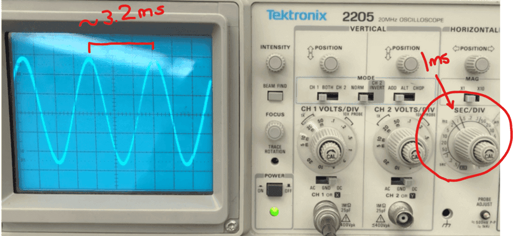

Photo of a Tektronix 2205 20MHz oscilloscope showing a sine wave on the screen with a hand-drawn bracket marked about 3.2 ms spanning one cycle, and the SEC/DIV knob circled and labelled 1 ms.
Period ≈ 0.0032s = 3.2ms
( Oscilloscope picture CC BY-NC-SA 3.0 of Libretext and UC Davis Library )

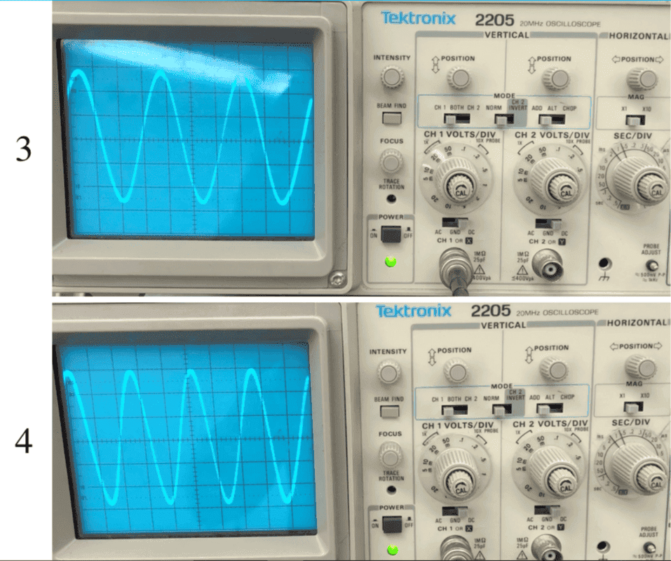

  • Four oscilloscope plots labelled A to D, each showing output current (A) against time (s) as a sinusoidal waveform, with peak markers and readouts on some panels.

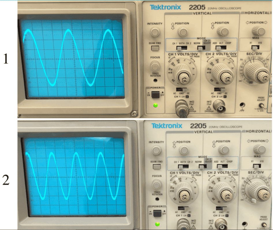

  • Two photos of a Tektronix 2205 oscilloscope screen labelled 1 and 2, each showing a sinusoidal trace; trace 2 has a higher frequency, with more cycles across the grid.
  • Two photographs of a Tektronix 2205 oscilloscope screen, labeled 3 and 4, each showing a sine-like trace on a blue grid display.

The oscilloscope reading (y-axis) should be so many divisions, scaled by the dial setting of volts per division. You may have included that somewhere, but I didn't see it.

As I read the periods, I calculate 1/T=f A=300;B=200;C=500;D=400 Hz
The Emf at oscilloscope images are
1-59 mV;2-51 mV;3-56 mV;4-58 mV.
I=Emf/[μo*N/(2R))*n*pi*r^2*2*pi*f]
  • Close-up of an oscilloscope front panel showing the CH 1 VOLTS/DIV knob with its scale labels, a FOCUS knob, and a TRACE ROTATION control.
This is something the OP should really be doing, instead of the Homework Helpers needing to sift through the data, but I get
A=3 => ##V_p=.056 ## volts
B=2=> ## V_p=.05 ## volts
C=1 => ## V_p=.056 ## volts
D=4 => ##V_p=.056 ## volts
I agree with the OP's matchings.

##I_p=(\frac{V_p}{f}) (\frac{R}{Nn \mu_o \pi^2 r^2}) ##.
I did some arithmetic, plugging in the values, and they were consistent (Edit=I had one arithmetic error that I found=it works now) with
the provided values of
##I_A=.141 ## amps
##I_B=.193 ##
##I_C=.089 ##
##I_D=.109 ##
Note: It helps to compute the second factor in ## I_p ## above separately=that way you only need to compute it once.
