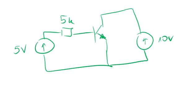

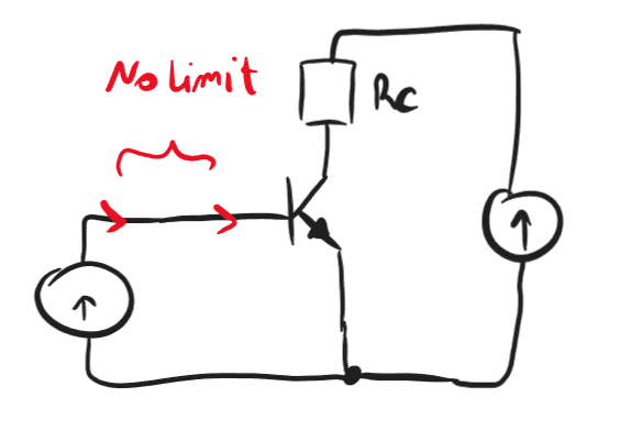

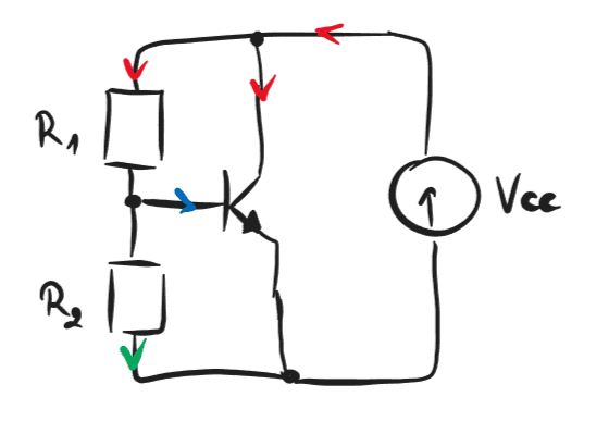

I don't understand transistors in combinations .... Or maybe basics ....
The discussion revolves around the understanding of transistors, particularly in complex circuit configurations. Participants explore the basic principles of transistor operation, the effects of resistors on current and voltage, and the challenges of analyzing circuits involving multiple transistors.

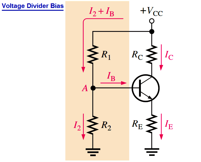

  • One participant expresses confusion about how voltage dividers affect the base voltage (Vb) when connected to a transistor, noting that Vb changes unexpectedly.
  • Another participant emphasizes that R1 and R2 should not be too high in value to avoid affecting the current drawn by the transistor base.
  • Some participants argue that the fundamental principle of transistor operation is based on current rather than voltage, suggesting that a small base current controls a larger collector-emitter current.
  • There is a discussion about the importance of understanding internal currents in BJTs, with one participant suggesting that VBE can be treated as near zero for circuit understanding.
  • One participant proposes simplifying the analysis by using a basic model of the transistor before moving to more complex configurations.
  • Another participant notes that the emitter voltage will rise due to emitter current, which will feedback to limit the emitter current, raising questions about how this feedback mechanism works in practice.
  • Several participants express uncertainty about how to analyze circuits with multiple transistors, particularly regarding the interactions between base and emitter voltages and currents.
Participants generally agree on the importance of current in transistor operation, but there is no consensus on how to effectively analyze complex circuits involving multiple transistors. Multiple competing views on the role of voltage and current in these circuits remain unresolved.
Participants highlight limitations in their understanding of how changing resistor values and voltages affect transistor behavior, particularly in more complex configurations. There is also mention of the need for feedback mechanisms to limit currents, which remains a point of confusion.

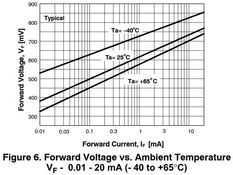

BJT is ultimately charge controlled. The following terminal equations are used to describe bjt:
Ic = beta*Ib
Ic = Ies *exp ((Vbe/Vt) - 1)
Ic = alpha * Ie
A good simulation program or lab tests will affirm that changes in current happen before change in voltage. A p-n junction has some capacitance, as well as inductance. At the frequencies the bjt operates at, capacitance dominates. The *Vbe* cannot change unless *charge* is injected into the b-e junction in the form of base & emitter currents, Ib & Ie. As soon as Ie changes, Ic changes a moment later, then Vbe eventually "catches up".
The easiest way to see this is to observe a simulation of a signal diode, such as a 1N914B, or 1N4148.
A simulation is attached. Notice how current exhibits the stair case function, while voltage gradually rises to reach the new value. The diodes voltage is determined by its current, not vice-versa.
An i-v graph of the 1N914B diode is attached. The Vbe "barrier value" depends on forward current. At 10 uA current, Vbe is just under 0.40 volt at room temp.
The Shockley diode equation simply describes the relation between I & V. It can be written 2 ways:
1) Is = Is * exp ((Vd/Vt) - 1),
2) Vd = Vt * ln ((Id/Is) + 1).
Just as Id = f(Vd), Vd = f(Id).
For further study, please search using these terms:
Diode reverse recovery
Diode forward recovery.
Finally, we can discuss *Early effect.* it is true that collector current is *slightly influenced* by Vce, collector emitter voltage, but this is relatively small. A 20% increase in Ie results in about a 20% increase in Ic.
But a 20% increase in Vce results in an Ic change *much less* than 20%.
To claim that the bjt is slightly "voltage controlled by Early effect" is not wrong. The key word here is "slightly".

So do you get confused if you draw in a resistor from base to emitter in the second schematic in post #13? Think carefully here.
I've triad to Understand the Re connected to transistor. But I had some problems with it because when i have also RB connected to transistor then Vb and Ve isn't easly determined the only know factor is that Vbe=0, 7V. But what is Vb and Ve value? I don't know.
Because if I know the Vb the i know the current Ib without it I don't know the Ic and I don:t know the current Ie which is in Ve. Or Rather it flowes through Re this current Ie.
Averagesupernova said:
Too much not yet relevant information. Why confuse the op even more than they already are?
DaveE said:
The OP is having trouble with the simplest of linear transistor models, he isn't ready for exponentials. The first step isn't accuracy, it's basic understanding.
That's right I have problem with basic Understanding of transistors.
I know only the thing I have showed from the tutorials. Like the Picture nr. 1 from post#1.
I just don't get it why transistor works from more complex situations such as Darlington or Voltage divider.
In tutorials or in the websites they say that resistor limitu the current, follow the basic Rules such as 0,7V and done.
Usually what I hear from others is that it is easy only Basics are Requied to Understand every Circuits and from that I usually feel stupid.
So maybe somebody can tell me the basics? Use my pictures to show me that those basics Apple there as well. I need guidance because those transistors are Tricky for me. I want to use them in audio or in LED Circuits but I don't get it.
This whole VC Ve Vb and currents such as Ib Ic makes me confused I don't know how to Approach it or how to Understand someones Circuit that has transistors. Or how to create my own Circuit wity transistors

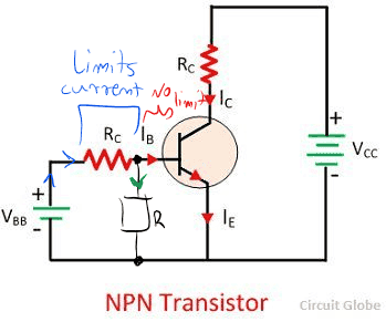

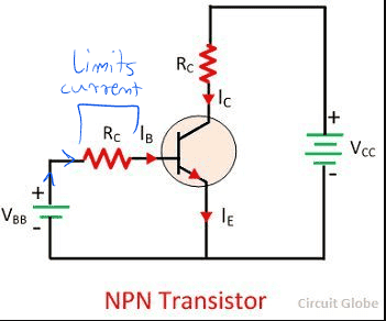

Xenon 02, I can fully understand that you feel confused.
Let me explain:
1.) It can be shown, prooved and verified that the emitter- and (with it) the collector current is controlled solely by the voltage Vbe. This is according to the well-known Shockley equation Ie=f(Vbe) with Ie=Ib+Ic.
The base current is nothing else than a very small part of Ic (and must be seen as a kind of non-ideality or an unwanted side effect).
2.) The well-known equation Ib=Ic/B is, of course, correct but if used in the form Ic=B*Ib it must not be interpreted as a relation between cause and effect.
3.) The problem now is two-fold:
(a) In some books and other contributions (papers and internet forums) the BJT unfortunately is described as current controlled (just a claim without any verification).
This is really a phenomenon - and it is simply false. This results from a false interpretation of the relation Ic=B*Ib.
(b) There are two mostly used small-signal equivalent diagrams for the BJT and one of the two contains the current-controlled view using a current source controlled by B (resp. beta). For some calculations, this works of course and can be used (because the formula Ic=B*Ib is correct) - however, this diagram must not be used as a basis for explaining how the BJT physically works.
In contrast, the other small-signal representation with a transconductance gm in the output circuitry mimics the physical truth.
Remember: Transconductance gm is the slope of the Ic=f(Vbe) characteristic gm=d(Ic)/d(Vbe). This results in gm=Ic/Vt and - surprisingly - for gain calculations, also the current-control defenders are using this expression (which results from the voltage-control function!)
4.) Resume: For some calculations you can use the current-controlled view (sometimes simpler) - however, if you want to understand the working principle of transistor-based circuits you will have no success with current-control (Why emitter resistor? Why low-resistive base divider? How works the current mirror? What is the Early effect? What means the tempco of -2mV/K ? Why Vbe<0.6V for class B-operation?...).
There are many effects and observations (and circuit principles) that can be only explained with the voltage-control view.

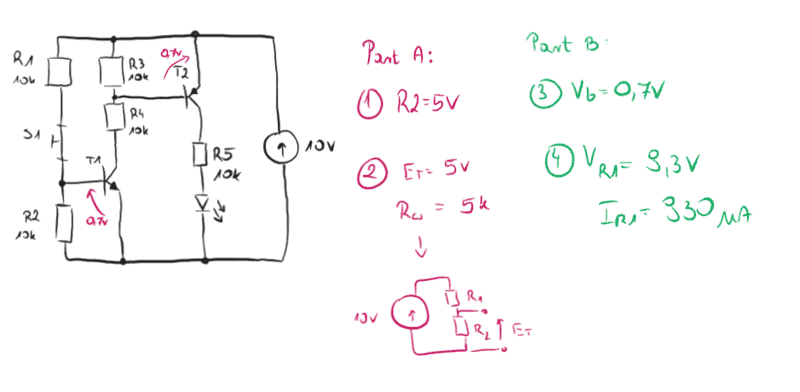

  • #42
@Xenon02, your confusion is understandable. A bipolar transistor can be a puzzle. You need to realize that the schematic with the push button and LED is NOT anything more than two switches. I know the voltage divider on the left is throwing you. The bottom resistor R2 really doesn't need to be there. It is common practice to the include it because with the push button in the open position the base would be left floating. Bad practice. I think you are able to answer the question of what is the base to emitter voltage when the push button switch is closed. You know about the .7 volts across the base emitter junction, so tell us what is happening with T1.
  • #43
About the circuit with LED, I heard that pushing button is like a switch but only when the transistor is in saturation. But what if it's in active :D
I mean that those transistors are a real puzzle for me when it comes to how the transistors behaves and why it behaves that way. Because when I tried to predict it with divider or in many different circuits I failed :D Because many factors were overhelming me. But this is only DC, if I added there also AC ... My god ...
About your question. The funny fact is that for T1 the emiter doesn't have any resistor so Ve must be equal 0V. So Vb is equal 0,7V. Even if it's a divider then on the 10k ohm it has 0,7V. Which is really weird I guess ? Why do I say it like that because what is this resistor really doing ? does it have effect on how much Ib the transistor receives ? But okey coming back to it. All I know now is that the T1 is working. It is probably working in saturation but it's hard to say because if we want saturation then Vce = 0,2V. There is current coming from PNP and current from R3. So yea, also in the collector there is another voltage divider ... Which changes the Vb of R4 and R3. Ahhhh. Also I know that there is something like Ic_max the maximal value that makes transistor saturated, but since PNP can provide any value for collector of T1 because the base of T2 isn't limited with any Rb_2.
Well I would also add that there is voltage divider on T1, usually there should be on 10k ohm Vcc/2 right ? Well at the end the 10k ohm won't have Vcc/2 but will have 0,7V. Why do we do that ? This resistor needs also current it takes some current from T1 to make this 10k resistor have 0,7V. I mean what is the purpose ? If I will make this resistor bigger or smaller will it affect the T1 ? If for example I changed the resistor from 10k to 500k then ? or from 10k to 10 ohm. Just giving random numbers.
  • #44
You're starting to see the light.
Hint: T2 is the exactly the same as T1 only upsidedown and a PNP. Imagine T1 being a push button switch and controlling T2. Simplify the circuits into smaller chunks and you will understand them. BTW, I told you why the resistor R2 is there.
  • #45
I mean in T2 it looks similat but it is connected to the collector of T1.
About the resistor R2 I know you mentioned that it must be there so that the transistor is not "floating" ? I don't understand this meaning but okey. But notice that it is still a voltage divider at least it looks like that.
So yea, basically R2 should have Vcc/2 but it has 0,7V. Even though Vcc/2 is connected directly to the base of the transistor it drops weird ...
Also what happens when I reduce the value of R2 or increase ? Like R2 = 100 and R2 = 100k.
Because even if this resistor must be because it must be it takes some current from transistor or something like that. Because what if this R2 had I don't know 0,2V then it won't rise to 0,7V ? As a divider of course. So many questions for transistor ...
Edit:
Maybe I am wrong but this R2 changes the Ib as I know right ? Even if it's for 0,7V or something like that but the value of R2 changes the Ib of the transistor ? So it somehow affects on the behavior of the transistor.
  • #46
@Xenon02 you need to brush up on basic circuit analysis, Kirchoff, etc. The diode that is the base emitter junction will never under any circumstance drop more than about .7 volts until it is damaged from over current or excessive reverse voltage. Because it is hooked to a voltage divider does not change this. The diode is the dominant part. Hooking a resistor in parallel will not cause the voltage to rise. If anything it causes it to lower slightly. A small enough resistor such as zero ohms and yes obviously the voltage will drop to zero.
  • #47
Okey so the voltage drops to 0,7V in the R2.
But R2 affects the current in Ib for the T1 as I know ? If I rised the value of R2 the current IB will change ? Or not ? I thought of it for a moment, because some current from R1 will go to transistor and some to R2.
So changing the value of R2 must do something right ?
Because you mentioned that it is there just to not make transistor float when the button is not pushed. But adding R2 changes a bit the Ib ? Or maybe it doesn't affect the Ib ?
Sorry if I am being to inquisitive, because it affects the value of Ic, and then even if there is a resistor for T2 that has 0,7V if there is not enought current Ic then the voltage will drop this 0,7V I guess ?
It is not typical for me yet :D That I see transistor without Rb just with voltage dividors.
  • #48

Yes it affects base current. If you fully had your head wrapped around Kirchoff and basic circuit analysis you would know that. There's no shame in having trouble with Kirchoff, etc. but please don't act like it doesn't apply to you or you've got it handled because you don't.
You seem concerned about R2 changing the base current a little bit. Well, it does. In the case of transistors being used as switches, we design it so it doesn't matter. We can suck a fair amount of current away from the base and the selected collector load is such that it doesn't matter.
  • #49

Re: The diagram in post #24.
R1 limits base current of T1 when S1 is pushed on.
R4 limits base current of T2 when T1 is on.
R5 limits LED1 current when T2 is on.
R2 and R3 (connected between base and emitter), are NOT there to be part of a base-bias voltage divider. When S1 or T1 is off, R2 and R3 will conduct leakage current away from the base without dropping sufficient voltage to turn the BJT base on to any extent.
0.1 V / 10 k = 10 uA maximum leakage when off.
0.6 V / 10 k = 60 uA wasted when on.
Since the supply voltage is many times VBE, the 60 uA will be insignificant when on.

@Xenon02 ,
I highly recommend that you draw the schematic as you progress thru this post AND DO THE ACTUAL CALCULATIONS FOR EACH STEP.Please post your results. That way we are all on the same page of the problem, rather than jumping around trying to answer multiple questions that keep changing.
This note refers to the diagram with R1, the push button, R2.
IGNORE THE REST OF THE CIRCUIT FOR NOW!
Since a supply voltage was not given, assume a 10V supply.
PART A:
1) With the button pushed, what is the voltage at the top of R2? (Ohms Law)
2) You stated that you knew Thevenins Theorem.
2A) Based on that statement, what is the equivalent source impedance for the voltage at the top of R2?​
PART B
Now connect the Base and the Emitter of T1 per the original diagram. (we don't care about the collector right now, so you can leave it not connected if you wish.)
3) What is the voltage at the Base of T1?
You now know the (nominal or unloaded) voltage at the top of R2 (Ohms Law from PART A above) and its equivalent source impedance (Thevenin from PART A above) AND the new voltage when the base of T1 is connected.​
4) You stated you knew Ohms Law.
With the equivalent impedance from #2 above, and the change in voltage (#1 & #3 above) at the top of R2.​
4A) How much Current is flowing from the bottom of R1?​
Discussion:
Because it is so low, in Almost all cases the current thru R2 can be ignored when the transistor is connected. For simplicity, we will therefor assume that all of the R1 current flows to the T1 Base.
You have now found the T1 Base current (#4A above). When you multiply that current by the β, Beta, or hFE of T1, the result will be the Maximum current you can expect to flow thru the T1 Collector (providing you don't burn it up!).
Even though they look like voltage dividers ?
Okej. But can I also use picture nr.1 from Post#1 as a reference to why I am confused ? Because all my confusions came actually from this 1st picture.
Those are results, I wasn't sure with Part A because I didn't understand if I was supposed to calculate getting rid of R2 or with R2.
But okey I can see that using this equivelant will make something like this :
But I do have some questions though.
If I can refere to the 1st picture of the Post#1.
I was taught there that Rb controlls or maybe better it limits the current that transistor takes from voltage supply and makes it into Ic.
So in this example I've used the equivelant but in reality the transistor doesn't have any RB or Should I consider R1 as a RB ? Sorry for saying dumb things I am stuck a bit with the 1st picture from Post#1. That there was always Rb.
Second question.
I can undestand that the diode is a priority and the R2 will have 0,7V because of the diode but if there was RE then the voltage on R2 would be more difficult to predict ? I ask it out of making circuits. I'll show later after some analizing a circuit that consist Re and other stuff.
Third question
Okej so the current is calculated for Ic and Ib. But adding new elements to collector won't change anything ?
Because for now I only understood the resistors examples (maybe except the one with Rb and Re, where I couldn't define the Vb and Ve) Adding now transistor won't make things a bit worse ? Now PNP can provide a lot of current. I am not confident when it comes to Adding transistor to another transistor. It is just weird because transistors are usually controlled by resistors but adding transistor to another transistor. I don't get it.

Those are the basic principles ? Isn't it like I said in my post#1 ? That we need to limit the Ib or something like that I said there.

You're saying the voltage across R2 is 5 volts and the base-emitter voltage is .7 volts. Am I misinterpreting this?
  • #54
I understood from Tom that I was supposed to calculate the voltage across R2 when there is no transistor connected to it.

Another question: When you have some problems with transistors (working principle and analyses of simple circuits) why do you want to start with circuits containing 2 transistors ? The same applies to the transistor in the handwritten figure (in green). This is an artificial arrangement without any practical relevance.
Recommendation: Let´s discuss the basic amplifier stage (your first post, second figure)

  • #57
They are not voltage dividers because the base voltage is fixed without reference to their ratio. They are independent devices performing different tasks. One half, R1 or R4, is limiting base current, the other half, R2 or R3, is mopping up any stray leakage.

Oh and to answer your question about two transistors, I thought that I understand the basics so I tried with something harder.
So let's say that I have analized first picture from the first post in which were RB, RC. Pretty basic. I think you have seen this analize of mine if not then post#10, you can agree or disagree with things I've said there.
So I can follow the reccomendation.
I need to get rid of the bad habbits I have abotu circuits. For now my mindset it : One transistor so there must be Rb to controll it and there is Rc or Re to define the max current, but adding other elements such as transistors then I get confused. Transistor is not like resistor that has current limits.

  • #59
Xenon02 said:
Also my confusion comes also when there is no RB for the transistor like in the dividers or connecting transistor to another transister.
If the current going into the base has to go through a resistor then you can consider that a base resistor insofar as it is limiting base current.
  • #60
Yea I tried to think of the upper resistor as an Rb. The thing is that the current is splitting into two pieces.
One piece is going into base which doesn't have Rb and the other piece is going into R2. So not limited Base can drain as much current it wants
