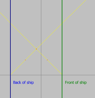

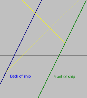

So let's place in the spaceship 2 lasers pointing at each other in direction perpendicular to the movement of this spaceshishp and emitting light waves in opposite phases. Then the observer on the spaceship will say that the light waves cancelled. But the observer in the rest frame will say no, the lights are 2 diagonals that cross at one point. Can it be possible?
The phase at the meeting point is not changed by Lorentz transformation. If we had a detector in the middle of the ship we would see the beams arriving in a certain phase. The intertial observers see the same same phase.
In the pictures I've indicated the peaks in the light wave as red dots.
