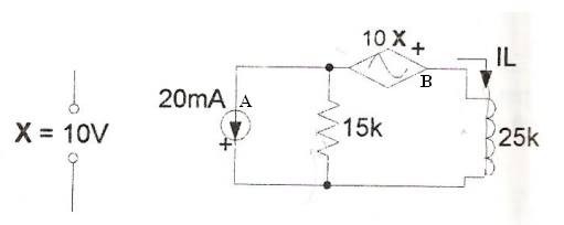

Use superposition to find [tex]I_L[/tex]
-The overall current is the sum of the currents supplied by each source individually
for source B only (current source is open):
---ohm's law: [tex]\frac{100V}{15k + j25k} = 3.43mA( -59.04 degrees)[/tex]
Here is where I'm having to defend my answer:
for souce A only (voltage source shorted):
---since there is no phase shift labeled, it should be assumed that the current source can be treated as a DC source, treating the inductor as a short, making [tex]I_L[/tex] -20mA
Is this wrong? Should I treat a current source as AC if it has other AC sources involved in the circuit? If this is so I'd just do a current divider to get [tex]I_L[/tex]
I believe the question would have to be more explicit in defining whether the 20mA is an ac or dc source.
Well no extra information was given than what's shown, yet I got it marked wrong for treating it one way over the other...
Am I going to have to call out my professor again? I'm losing all my brownie points because of his dud test questions
I would imagine the "+" by the current source tells you it's a dc source.
Well actually he graded it as it being an AC source.
If you are answering the question as part of a test and if the professor is not available to clarify, then I guess you could always offer both solutions, one for each case.
Failing that, then I suppose at the last resort you should treat it as ac since, as you said, there are other ac sources in the circuit.
Hmm... but a "+" sign also appears beside the dependent voltage source and that one is clearly ac.
Haha! Yes, it does. What on Earth is it for, then?
For the dependent voltage source, I would imagine that it is there to indicate where the +terminal is (neccesary in defining voltage). I don't know why it appears beside the current source.
