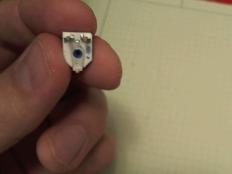

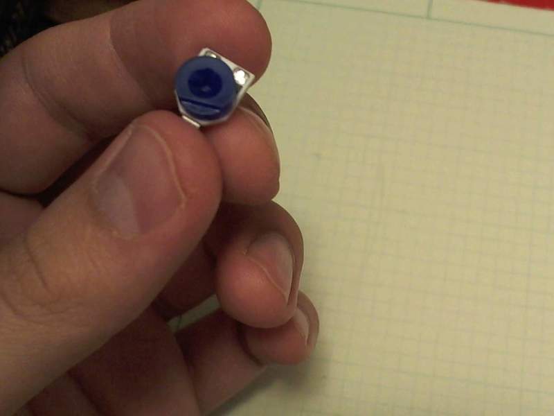

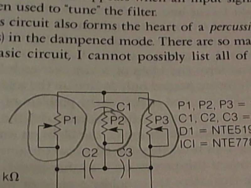

2) The pitch of the drum sound comes from three 1 Mohm potentiometers. These have one pin on one end, and two pins on the other end. I will describe the way that the schematic represents the potentiometer:
There is a point below a "resistor" symbol (jagged line). The point is connected to the jagged line. In addition, there is an arrow emanating from the point, making a square-shape away from the line (wire), then pointing directly back at the jagged line.
My question is this: I don't know which way to orient the potentiometer - where does the one-prong end go, and where does the two-prong end go. The two-prong end on a breadboard is going to end up being on the same row (obviously), so I'm pretty confused as to why there are two ends at all. Obviously I'm not completely clear on how the potentiometer works - and due to time constraints I've got to jump into this project feet-first.

Pots generally have a center pin that is the "arrow" in the schematic. That pin can be twiddled anywhere between the two outer pins giving a variable resistance.
Try it all out with an ohm meter and see what's connected to what and what resistances you get.
