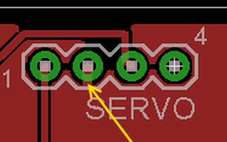

Why is the red (power: pin 2) wire for the servo motor not connected to anything in this circuit?
https://github.com/samyk/combobreaker/blob/master/Eagle Files/ComboBreaker_top.pngAlso, on the "bottom" schematic, the ground is connected to the feedback (potentiometer wiper) line:
https://github.com/samyk/combobreaker/blob/master/Eagle Files/ComboBreaker_bottom.png
Since I am making this project without the encoder, should I still connect that feedback line to the ground?
Perhaps I misunderstand but.. Pin 2 of the "Servo" connector _is_ connected to something. It's connected to the power plane on the top layer. See arrow.

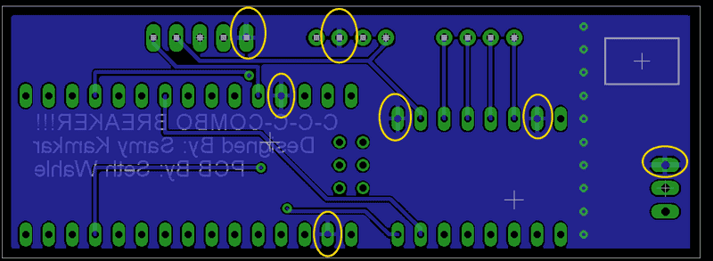

Generally power (5V) and ground (0V) are needed everywhere on a PCB because all chips need power. Instead of using PCB tracks for power (5V and 0V) what they usually do on a 2 layer (eg double sided) PCB is flood all unused space with copper and use that like a big track. On one side that's used as power and on the other it's ground. Clearly signal tracks could cut these planes into isolated smaller planes, in which case wire links have to be added to ensure they are all connected together.
On a 4 layer PCB things are easier as the inner two layers can be reserved for Power and Ground only and the outer two layers used for other signals. This gives you a nice large plane of copper on the inner layers to distribute power and ground. Connections are made to the inner layers by drilling a hole and electroplating the inside of the hole.
On the image below I've tried to highlight all the connections to the Ground/0V plane. I can't guarantee I haven't missed one but I think I got them all.

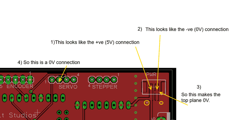

STOP PRESS...
I've been looking at the layout more carefully and it appears they might be using both sides for 0V (eg the top plane isn't 5V it's 0V as well). More to follow...
Ok yes my mistake, both of the planes appear to be 0V on this board and pin 2 on the servo is connected to 0V. See numbered comments on the diagram..

Yes you will need to figure out which of the 4 pins on the PCB the 3 wires of the servo should be connected to.
It looks like Pin 2 = 0V = Brown wire but the others are harder to work out. Is there a circuit diagram for the PCB? I couldn't immediately see one.
