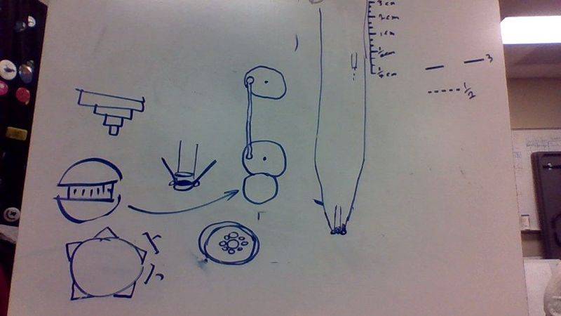

Ok. So while in my trig class, I had an idea for a ball point pen that, when writing, it has an automatic mechanism for making dashed lines. I mean to say, it lifts the ball point or obscures the path to create a perfect dashed or dotted line, or allows to draw a line of fixed length for measuring before writing. My first inclination was some sort of really basic mechanical calculator, in the pen, to calculate the distance the ball has rolled. Problem is, I don't know anyone who can help me figure out what to do. If anyone understands how these things work, I'd like help designing a prototype for now. Thoughts?

Oh, no, What I mean is for a pen to draw a specified amount no matter the direction or curvature of the drawing. Ok, I want it be like any other pen, no straight edge, no wheel, Just a basic ballpoint pen, but with an internal mechanism that automatically draws in the ball at specific intervals specified by the distance the ball rolls. Separate from what kind of line you want to draw, so no straightedge.
Think about cylinder with small cuts in the axial direction, when the cylindrical pin rolls it makes dashed lines at specific intervals , but you cannot change the length and gap between dashed lines, any way your line of thought is good

I think you will have to take a good look at how a ball point pen works. By rolling on the page it draws ink from the chamber above and transfers the ink to the paper. If the ball is drawn into the chamber the increased pressure on the ink will push a little bit more out and when the ball releases there is a good chance of finding a blob of ink on the paper. That is one issue to overcome.

I'm aware of how that works. I should have specified that the chamber would have to move itself. I know that when you press on the ball, it pushes on a chamber that draws in the ink. I had figured that could activate the calculator for drawing. At the very least that should help with the issue of making sure that the line fits (brought up by berkeman). The only problem I'm seeing right now is how to make a continuous stroke of the pen if the chamber is being drawn in.

Ok. It has been a while since we've talked. I was able to get some ideas going with my physics/robotics teacher.
For now, I'll have to leave you with my notes. If you have questions about what they are, just ask.

Maybe consider mounting a small diameter eccentric wheel on the side of the pen. It would have a soft rubber tyre, or maybe a rubber disk on the outside edge, that would keep the wheel turning while the pen was resting on the paper. As you draw a line, the pen rises and falls producing the dashed line.
