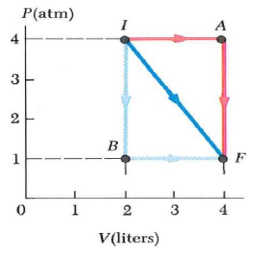

Calculate the gas' mechanical work on its environment for the thermodynamic process path IF.
Solution says: 505 J
W=\int_i^f p,dv
i = Vi, initial volume
f = Vf, final volume
My approach is to find a function for p(v) between 2 and 4 liters.
p(v) = 709275 - \frac{3}{2} * 101325 V (Pa)
And then integrate it from 2 to 4 liters, which is 0.002m3 to 0.004m3
Problem is, I get:
Which is way off. I should get 505 J..
I'm stumped. What am I doing wrong?
where did you get your 709275 number?
Anyway, I make it about 306 J.
Oh, I should have stated that. I extended the IF line to where it intersects with the Y-axis, which is 7 atm.
7 * 101325 Pa = 709275 Pa.
You got 306 J... it should be 505, unless the document is wrong.

The first time I just calculated area = 1/2 bh and got 306.
This time I did the integration and got ~ 518. And I found your mistake - in your 2nd term under the integral you divided by 2 instead of 0.002.
Still don't know why 1/2 bh didn't work! :frown:
Thank you for your help. Gonna ask the professor about it, he made the task after all.
The second term is -(3*2) because that is the gradient of the curve. That should be correct.

It's not correct. The second term should be -(3/2) * 101,325/0.001 V.
I wouldn't go to your professor 'till we agree on this.
My God, that seemed to do the trick.
This seems right to me.
I gather since I converted from atm to Pa, and integrated using m3 instead of liters, I also should have taken that into account for the gradient.
Is that assessment correct?

That assessment is fully correct! :smile:
