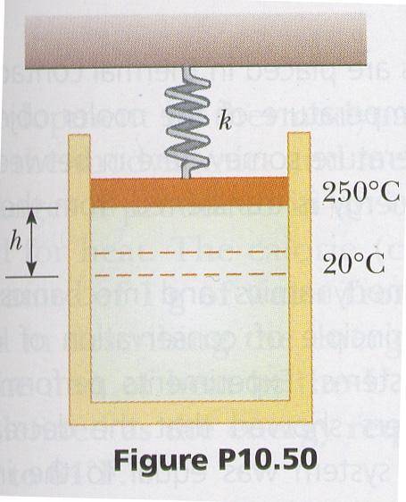

A cylinder has its lid connected to a spring with k = 2000 N/m. The cylinder is filled with 5.00 L of gas witht he spring relaxed at a pressure of 1.00 atm and a temperature of 20.0C. (a) If the lid has a cross-sectional area of 0.0100 m2 and negligible mass, how high will the lid rise when the temperature is raised to 250C? (b) What is the pressure of the gas at 250C. Diagram of this picture is attached
PV = nRT
F = PA
F = -kx
In looking that the diagram, I identified three forces experted on the spring. The normal force by the air, spring force and weight force. Since mass is neglitable, there is only the spring and normal force. Therefore, my equation came out as:
N = S
PA = kx
Just by looking at the question, I know we have A and k given in the question, and what we are looking to solve is x. Therefore, in an attempt to get P, I used the ideal gas law:
P1V1 / T1 = P2V2 / T2
1atm * 5.00L / 293K = P2V2 / 523K
P2V2 = 8.92J
Now what do I do? In order to get pressure, I need volume, which is an unknown at this moment... Any clue or help would be useful, thanks!

Sorry, was a bit hasty as I was cooking, the forces on the diaphragm at equilibrium:
F=-KX is the equal and opposite to p2*A, hence Kx=P2*A or x=P2*A/k
and delta V= A*x, does that help?

The pressure on the air in the cylinder is given by the spring and the atmospheric pressure. Initially, there is no spring force.
P_iV_i = nRT_i
from that you can work out n.
Now, as T increases and V increases, the spring is compressed which increases the pressure.
P_fV_f = nRT_f
Since Vf = Vi + Ax and Pf = Pi + kx/A, this can be rewritten:
(P_i + kx/A)(V_i + Ax) = nRT_f
Try and work that out to get a solution for x.

Hey denverdoc, I used your method and I got 1.79atm for the pressure and 8.95*10^-6m for x. I think the pressure is right but x is wrong, since the value is too little to be noticeable in a real life experiment. This is what I did:
N = S
PA = kx
P2V2 = 8.92J
P2(v1+P2(a^2/k)) = 8.92
P2(5.00 + P2 (0.01^2 / 2000)) = 8.92
P2 = 1.79atm, -1*10^8atm (rejected)
P2A = kx
1.79 * 0.01^2 = 2000x
x = 8.95*10^-6m
I do not think there is an error in my arithmetics and algebra. I double checked them. But I may have made a mistake

Its a stiff spring, but 4 or 9 microns seems small indeed. what is the initial height of 5L at 20 degrees? .01 m^2 =100 cm^2 is about 2 inch radius for nearly gal and a half volume. I'm wondering about units--atmospheres need to be converted to N/m^2.

P = 1.79 atm, x = 0.907m. Sounds much better. Thank you!

heres what I get p2=1.64atm--its tricky because of the units always changing, but the A^2/k term needs to be multiplied by a million to convert from m^3 to liters. since 1.64 atm =98,690 N/M^2 *1.64,
x=.81m.
This result I like because it shows that the expansion is clearly constrained by the spring, and that the pressure is higher than if unconstrained.
